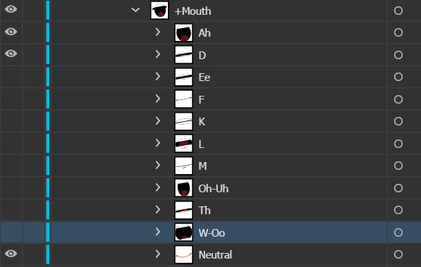

Error (2.1.1.x7) Invalid File Tag
When recording and during playback I will get an error message ~ Invalid File Tags.
When this error occurs it sometimes stops recording. Playback will also trigger this error. Eventually, the error will continually popup forcing me to use the Task Manager - End Task, to shut down the program.
I have not modified my characters for several months. To try and remedy this problem I have spent several hours going over each layer and making sure the structure is correct and named properly. I have tried different variances of naming and tried removing the + character. This did not help.
Please help.

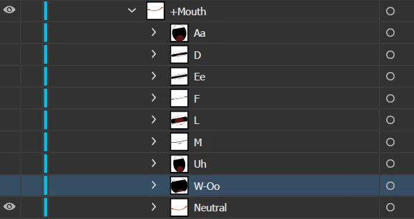

    Thank you Dan Tull and all of you wonderful people. The problem was an extera mouth shape. I had a "K" and a "Th" mouth shape in my Illustrator drawing. Once I deleted these it worked fine. Thank God.
