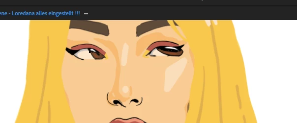

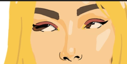

It seems like the eyes fix on top of the pupil, because the rest is moving(or try to move)
I can also load up the character, but i am a little bit desperate...
Thx for any help 🙂

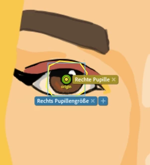

It looks like your right pupil layer has a handle on it (see the number next to it?). These can cause problems like you are experiencing. Putting a tag on a handle is not the same (always) as putting a tag on the layer. The warping looks like the center of the pupil is getting stuck, near where the handle is. So my first suggestion is to remove the handle on the pupil layer.

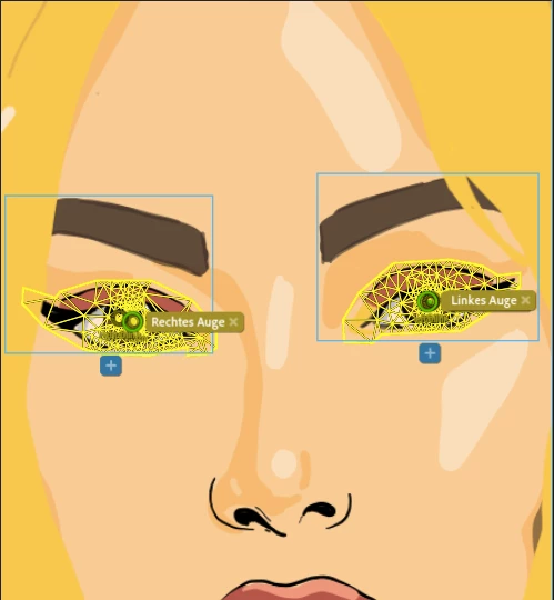

If you turn on the yellow mesh icon at the bottom of the scene window it shows the mesh as it distorts. This can be useful during debugging. If you can see where in the mesh something is not moving (is stuck) that can narrow down where to find the problem. Eg i suspect it's the center of the pupil that is stuck, but watching the mesh as you move can confirm this.

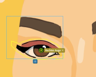

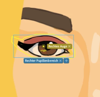

Thx for so many help, but i dont get it work, so i fix the handle thing and remove them from the pupils, but now, nothing happened any more, she can blink, but the pupils does´t move at all
