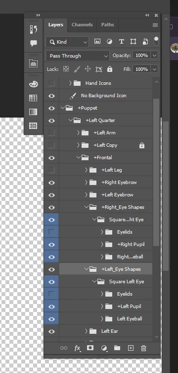

I know this will be a simple Photoshop, I didn't turn it on problem, but I am not able to get my eyes into the behaviors panel to set as triggers. Also related does anyone know how I can see the full file name in Photoshop and not the ... I am not sure even what those file are?
Problem I am doing a horror animation and want the pupils to latch on and off.

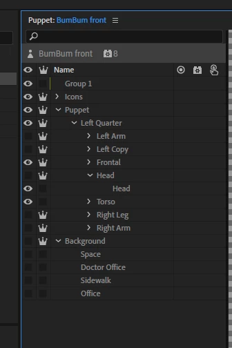

I am not seeing the head or body in your hierarchy. The eyes need to be nested inside the head and the limbs need to be part of the body. Also, you have frontal layer nested inside of the left quarter when those two layers need to be on the same level. Technically, each view in the body turn needs to be a complete puppet with head and body, etc. or the body will not be able to turn. I am not sure if that is your intention.
