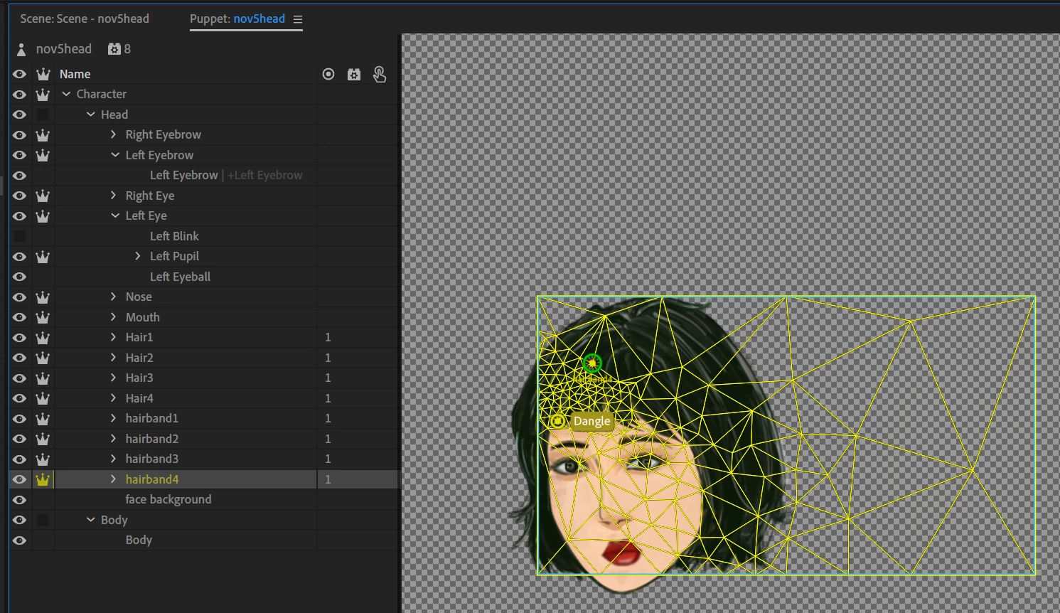

    If you click through the rigging window, it can help track down problematic layers. For example, this head band is rectangular (an indication the artwork is not contiguous). This layer needs fixing.

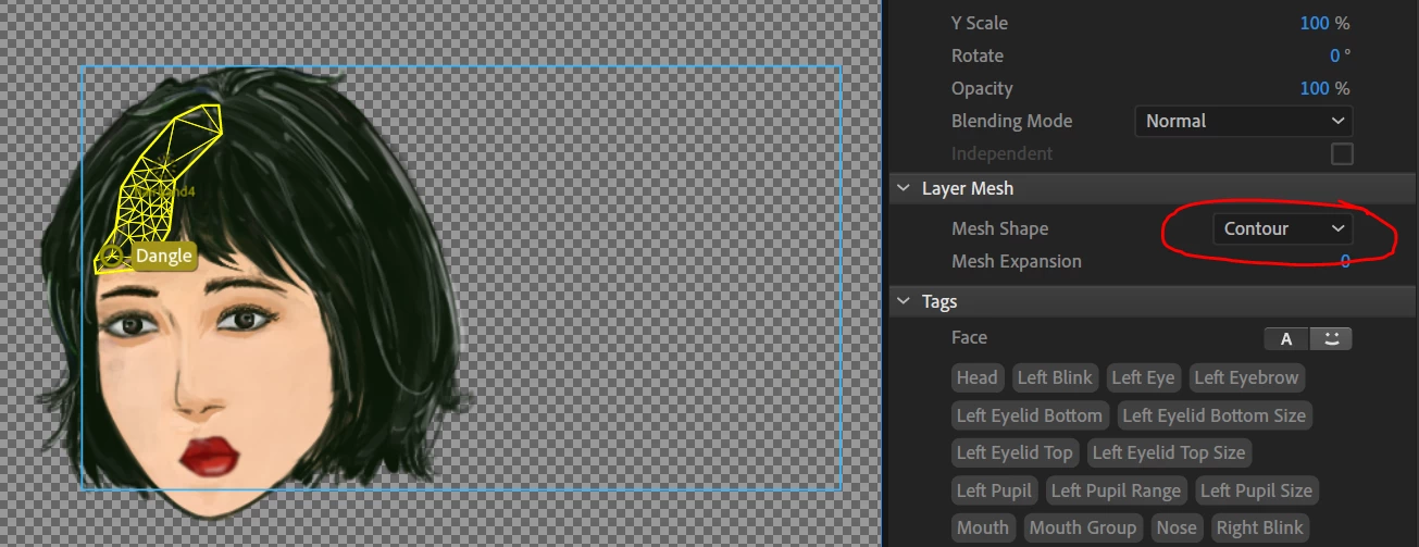

    Changing the mesh shape to contour can help.

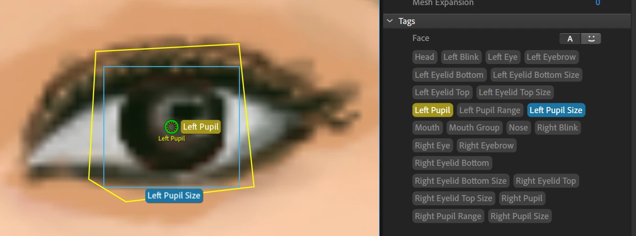

    But the real issue is the eyes - pupil range and pupil size. The pupil size seems fine:

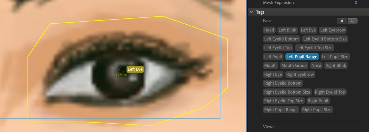

    But the pupil range is not much bigger....

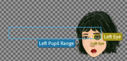

    except the blue bounding box IS much bigger!

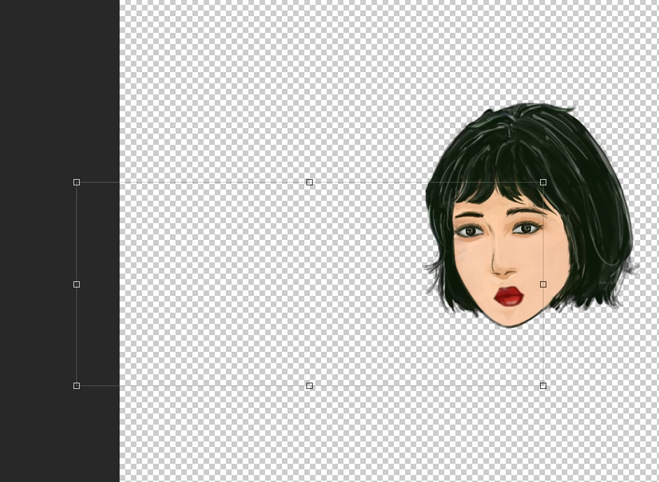

    Jumping into Photoshop (where I am NOT an expert), it appears there is content off the edge of the artboard which CH is seeing. If you select the "Left Eyeball" layer with the "move" tool, you can see the bounding rectangle it comes up with? See how it extends off the artwork boundary? I think there are some rogue pixels turned on in this area getting CH confused.

    Hi alank99101739, thanks for your fast reply. I checked  the rouge pixels and I think this is beacause I used a drawing app named Procreate to draw the character, and expoted as a PSD to work in photoshop. those pixels are dots accidentally added on the canvas and I did not see them well. Now I’ve got them erase.
    For the eyeballs I still cannot get them moving. Maybe I’ll try redrawing and make the pupil range larger than pupil size.

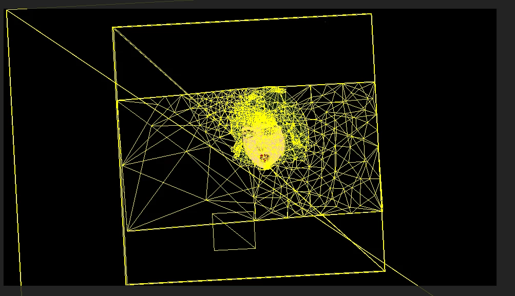

    If you turn the mesh on, you will see there are lots of stray pixels going on. in layers.
