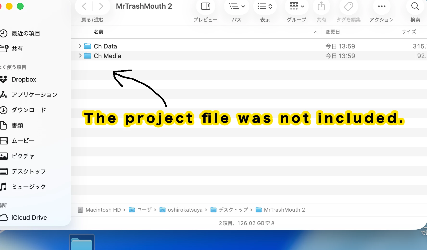

I downloaded your Zip file from Dropbox, but it didn't contain the project files.
Could you please re-upload it with the Character Animator project files included?

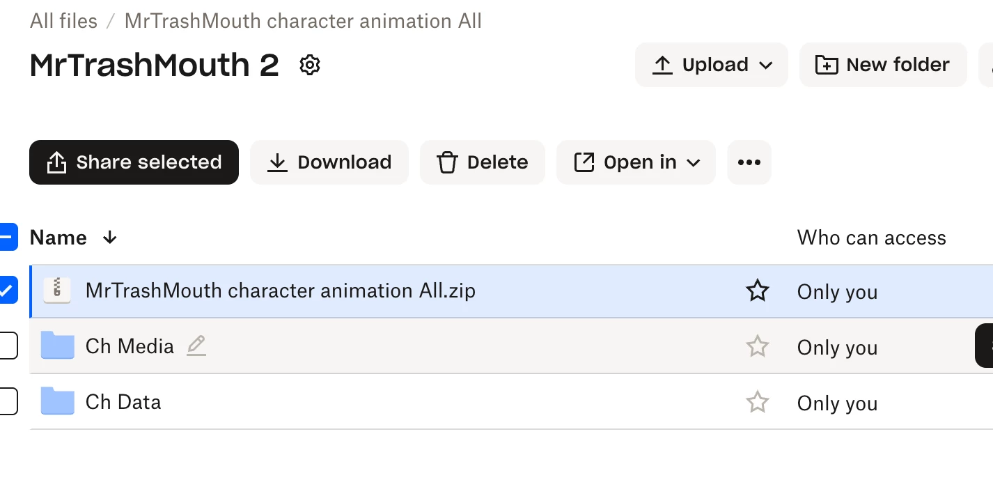

Thank you, I just found out that you can't upload chproj files into Dropbox because they 'contain no data'.   I was able to Zip the whole project though, I've put it where the project file should have been.

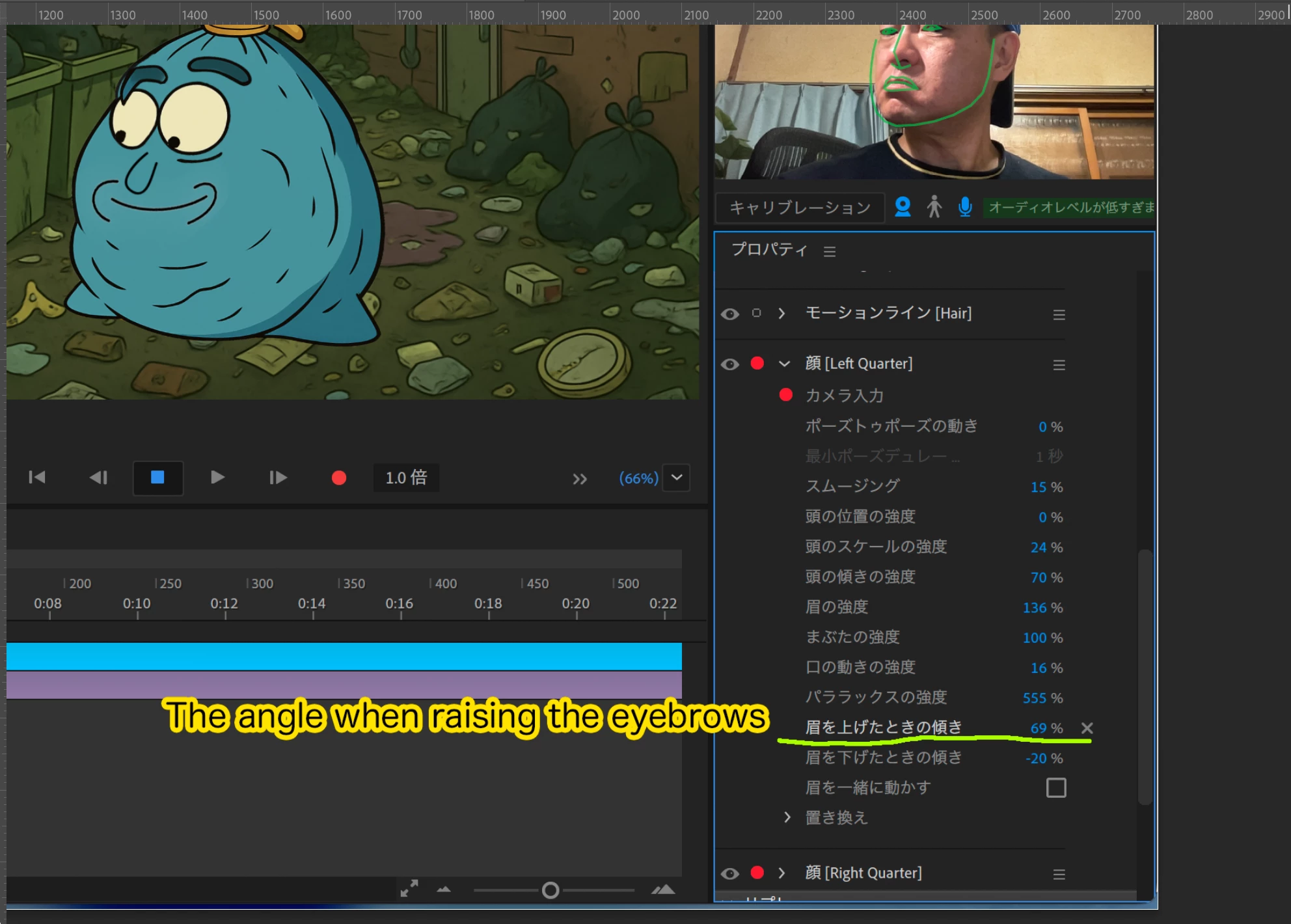

I tried moving your puppet, and it seems to work fine.
Even when turned sideways, the eyebrows and nose respond normally.
If you want to make the eyebrows move more dramatically,
try increasing the value for
“Eyebrow Lift Angle” in the behavior section for each head?
Given the fairly complex rigging you're working with, insufficient PC power could be a factor.
One approach might be to simplify the rigging or try it on a PC with more capable graphics, memory, or CPU.
