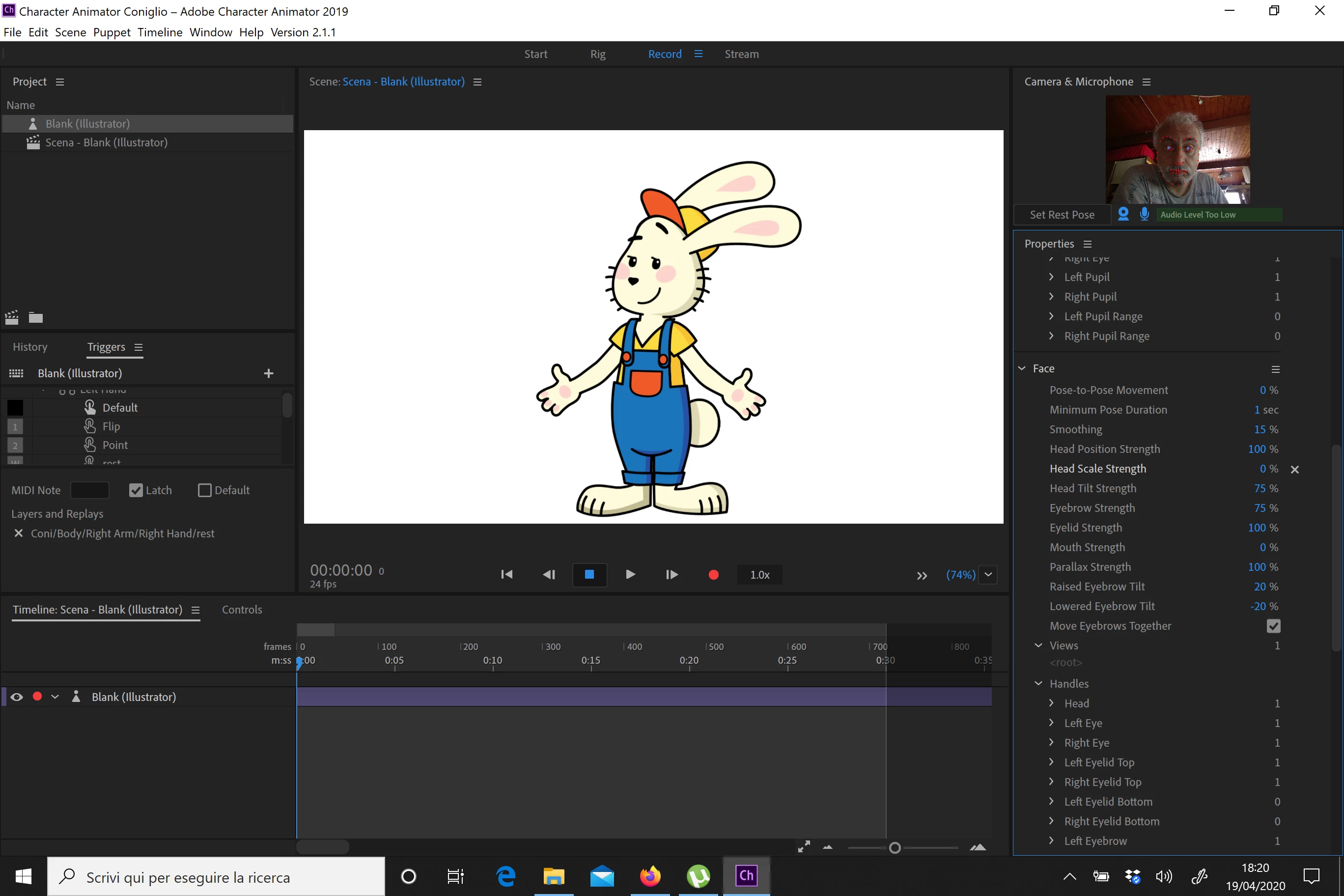

HI, I created my character starting from the "blank" character and replacing all the body and face parts in Illustrator. All naming seems to be correct. When I try to use my character in "recording" mode the eyebows are not behaving properly: if both "crowns" are on, only the left brow will move and defor the left side of the head. If I disable both "crowns" the brows will move together but they will deform the head too. I tried all possible combinations but I don't seem to be able to make it work. Thank you

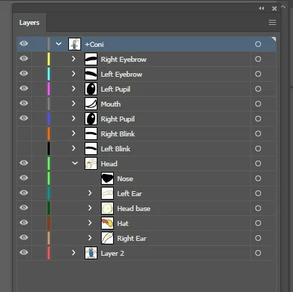

Hey, thanks! I didn't expect such quick answer. Here is a screenshot of the illustrator layers. I tried to keep all original layers from the blank character
Apr 19, 2020 5:17 PM UTC
Hmm. Looks okay, although I would usually have those facial features in the head layer, but it should still be working.
The eyebrow tags might be associated with the wrong layer. For example, when rigging, we accidentally have the head selected when tagging the eyebrows and then the head warps because the program thinks the head is part of the eyebrows.
You can try checking your tags and make sure the "right eyebrow" and "left eyebrow" are marked correctly and that no other layers are using them.
