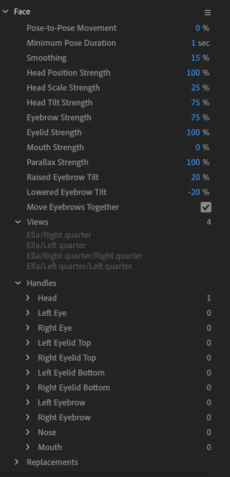

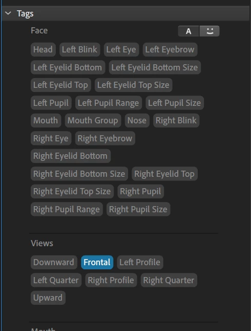

    Your "Front" layer should be called "Frontal" to get autotagged. It spotted the other profiles, so assumed there should be a "Frontal" as well. You can tag "Front" by hand (which I did here).
    How I debugged it - I went to the "Face" behavior and opened up the Views and Handles sections.
    See that Views is confused as well - it has Ella/Right Quarter and Ella/Right Quarter/Right Quarter both present. You will probably want to clean that up as well. But there is no "Frontal". (There is no Head under those profiles, so I assumed they are not finished yet?)
    Also see the "Handles" section. There are no Left Eyebrow etc links made. That is, the counts are all zero.
    So I clicked "Front" in the rigging panel then added "Frontal" to the "Front" layer.
    An alternative if you don't want heads to be in the profiles is to remove the root puppet Face behavior and add the behavior to the Head layer, so it does not see the profiles and get confused (it will only look at children of the layer it is added to).
