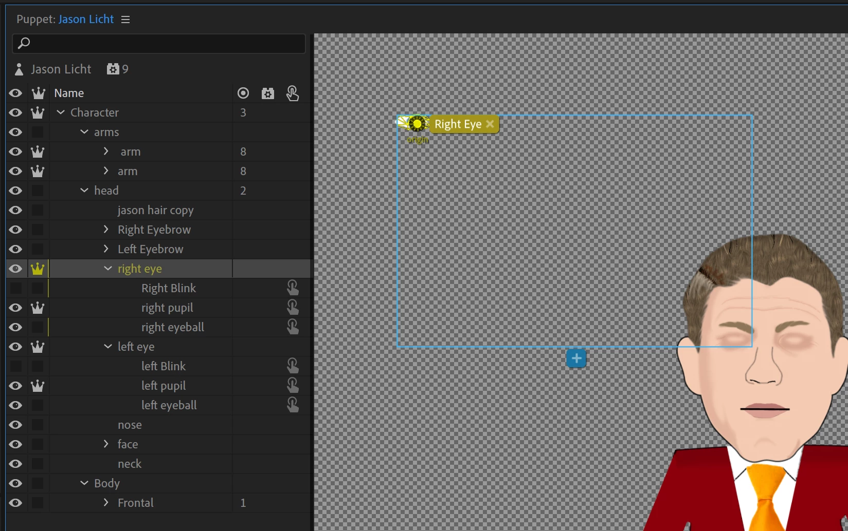

I can't figure out why I can't get his eyes moving. Something strange is goign on where its taking the parts and randomly putting them far away from where the eyes clearly are. Any ideas?

A few suggestions. First, the eye in the puppet seems off in a strange position (not on the face).
It is however correct in the artwork file, so I would suggest clicking ALT-refresh (the little two arrows in a circle at bottom of scene window) to flush CH caches to see if that helps. I will drag the eyes back over the head for now to keep going.
So why does the pupil not move? Because the Eyeball is defined as the range for the pupil to move in, and the pupil takes up most of the space.
If you want the eye to move down so it is clipped by the eyeball (not limited by the eyeball), you need to create a new Pupil Range layer bigger than the eyeball, then hide it. It does not need to be visible. Turn the Pupil Range tag off the eyeball layer and put it on the new invisible bigger object. Then put clipping on the pupil layer.
