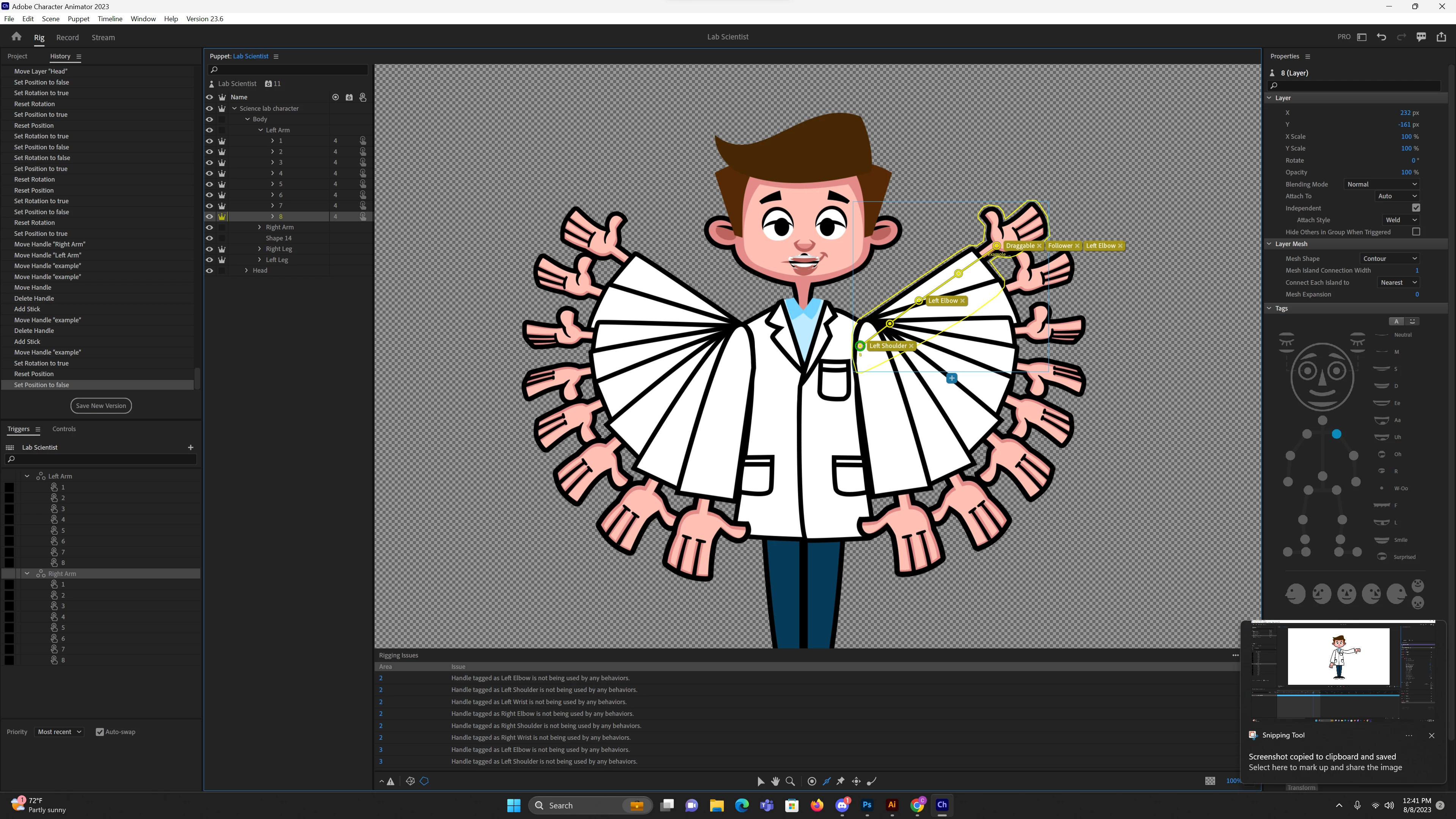

Facing some difficulties with leader follower behavior
i made a puppet in photoshop and he has auto swap arms with the dragger behaviour only on its leader arm
and the followers dont have the dragger and i tried moving its arms and they dont auto swap when i wove my mouse to the edge of the monitor then they work a little bit do you have any advice

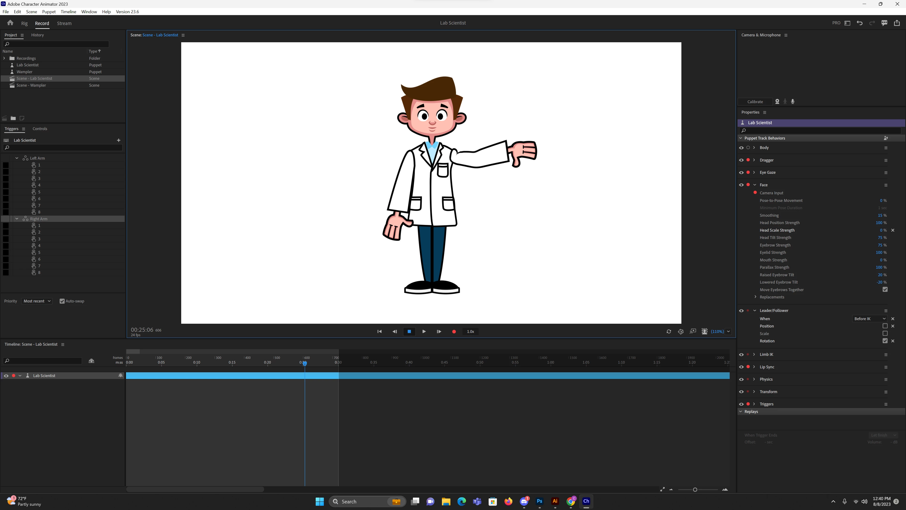

Aug 9, 2023 1:06 AM UTC
now its workes i figured it out after 2 hours of trial end error i had to place leader follower behaviour n the arms seperately

Aug 10, 2023 3:54 PM UTC
Good to hear you got it working.
Whatever works is fine but you should not need N leader-follower behaviors. With multiple leader handles, you do need to rename the handles properly. Followers follow leaders with the same name in case there are many leaders. You may want to check this.

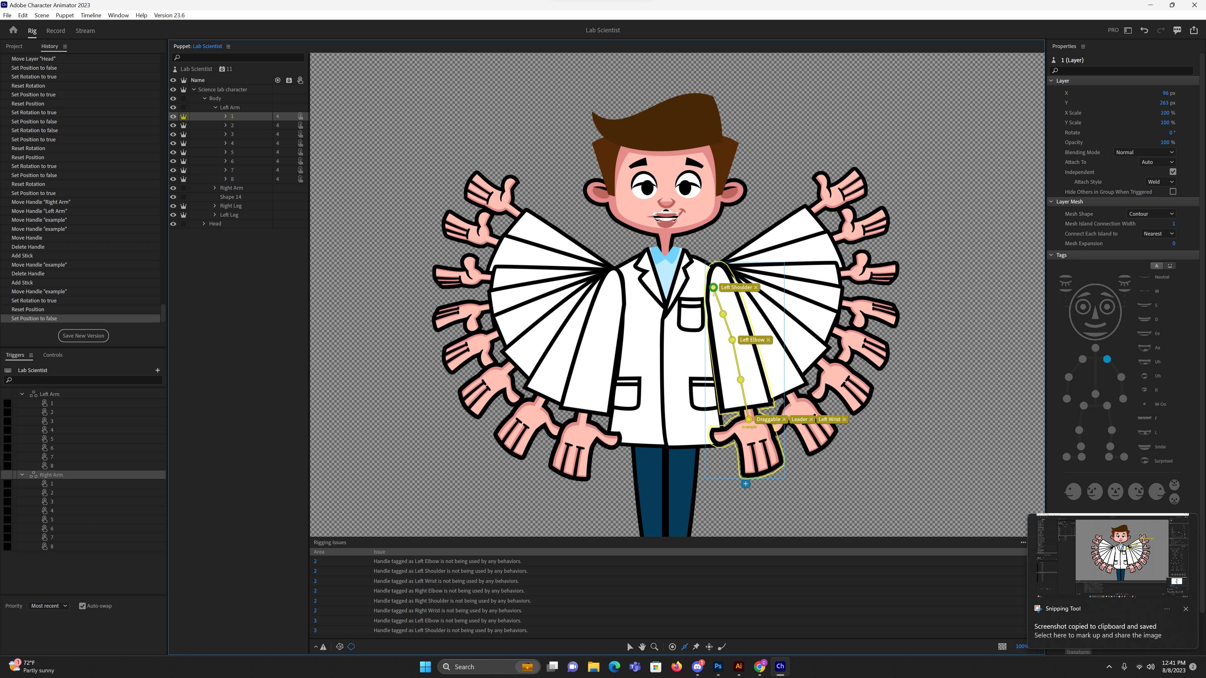

ParmJaiyaAuthor
Aug 9, 2023 1:04 AM UTC
I figured out something when i rig the second arm then it doesnt work but whni have one armed rig then it worked
