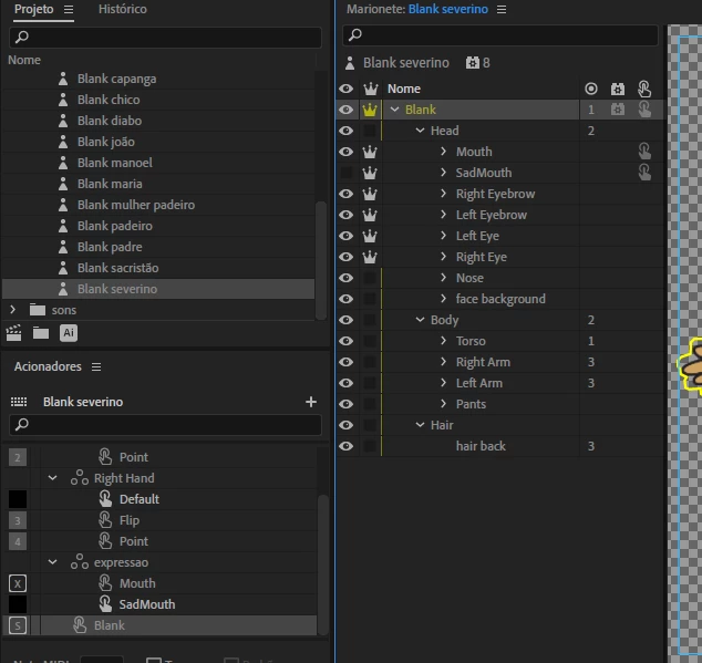

I'm super new to character animator, so I don't know what I'm doing wrong here.
Basically I'm trying to make my puppet fade in an out right? But when I add the behaviour and trigger and go back to record mode, the puppet is transparent and pressing the key doesn't do anything. What am I missing here? I watched the guide to triggers and did as shown but its not working. The opacity is at 100% and if I try to do this to just one part of the puppet or to another one the result is the same - that part is invisible and won't turn back to normal. Help?

Jul 8, 2020 6:20 PM UTC
But what if the intention is making it disappear smoothly, like, just that? Then it is supported? I made the "whole" puppet have the bahaviour and it was just invisible, the trigger didn't work. I'll attach a screenshot here. I'm sure it's an easy thing to fix, but I'm not getting it. Oh, nevermind, I got it to work. I guess it was always working but since the scene had so many puppets, each with their own animation and parameters (one has the walk behavior, so that's gotta be heavy for my poor old notebook to handle). I'll... Post it anyway, just to see if you can tell me how to make the default trigger be the "visible" part first instead of invisible then, when the key is pressed, visible (then invisible when released but this in particular is solved if I use the latch command). Or I just hit record with the trigger "on" and set to visible instead of "off" and invisible (the key pressed instead of not)?
