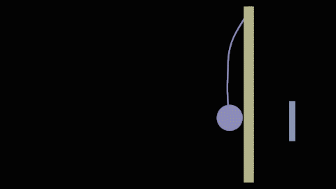

So my issue is that right now I can't seem to get a dragable object to dangle and have physics collisions.
Basically I have a dangling ball that needs to collide with a pole in the middle but also needs to be dragable. This doesn't seem to be possible with what I have even though it seems to be kind of working.
The red rectangle I threw in to test physics and it will collide with the pole when it's dragged into it but not the ball. The ball will collide with the red rectangle but not the pole.
I need the ball to have similar behavior to the rectangle at least and I'm not sure how to continue.

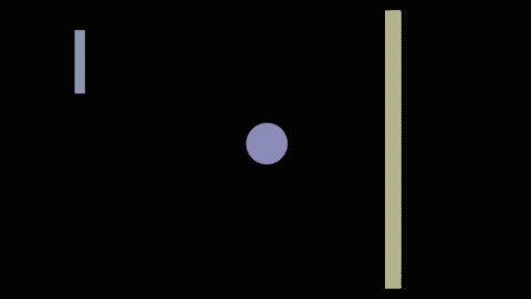

Not sure if useful, but you can have fun by changing the direction of gravity. I set the ball gravity sideways, so it bounces back to the poll. Bu there is no visible cord. And recording and playback look very different, making editing next to impossible. Oh well! (I was hoping I could hit the ball, then put a cord on there afterwards and drag the two ends to manually keep them connected to the ball and pole. But I think it will be too frustrating.
You may have to resort to not using physics - just put a dragger on the ball and pretend to make it bounce. The following is not very good, but its just done with manual draggers. Obviously need to get the timing right to make it look like the bat is hitting the ball!!! (hard)

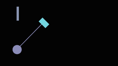

Ah! I think the answer is much simpler. It won't work.

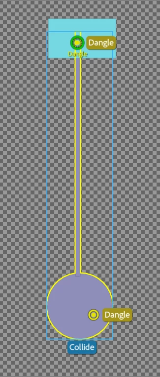

That is, I don't think the physics engine is smart enough to understand dangles.  I created a puppet that was a block, a thin "cord" (a thin rectangle), and a ball at the end. I put a dangle on the ball.
I then placed it in a scene at 45 degrees, causing the "cord" to bend.
For clarity, without the dangle it looks like:
I then dropped a rectangle (collide + dynamic) from the top of the screen on the version with the dangle. It is a bit quick, but the rectangle drops straight down and hits the "cord" as if it was not bent. It lands on top of the ball  which stops it falling to the ground (where it would be without the dangle), and tips over to the side against the cord. (I positioned the rectangle carefully at the start of the scene! ;-)
I put a dragger on the rectangle - as I drag it around, you can see it follow the outline of where the cord and ball would have been without the dangle effect.

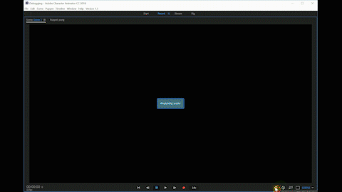

Also, as soon as you drag the object, it sticks to the drag position. Dynamic behavior when you hit record does not get reset, so you start recording but the rectangle looks like it has already fallen (when you play back the recording it does reset, but you cannot tell during recording mode - not very intuitive). I then dragged the rectangle around while recording, which was all recorded and played back. But the rectangle would stick where I left it. I then trimmed the start and end of the take. That caused it to fall based on where I trimmed it to. So I could get a drag to work on a dynamic object - but it was by trimming a longer take recording - doing a simple record was not good enough.
