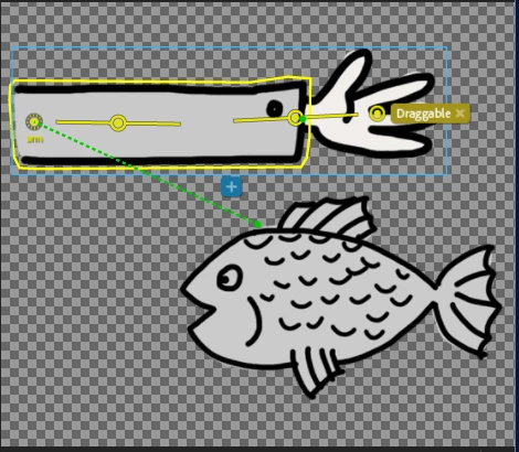

Glossing over "errors" in magnet video
In the Okay Samurai video
https://youtu.be/ivt3zQ0zni0
The arm reaching for the fish contains "sticks" to control abnormal stretching.
Yet when in record mode the arm stretches like crazy.
What is going on?
I'm using v. 3.1. Is that something to do with it?
Are other people also having problems with consistency in models and behaviours when they stray from the straight forward copy and modify approach to character animator?
Thanks
Robert

This is true of any draggable handle you add into the app, unless you add the Arm IK behavior as well. Sticks only make certain areas more rigid, but will not prevent stretching.

Feb 11, 2020 6:55 AM UTC
Thanks.
I can see that now, from many many failed attempts.
Learning CHA is less straightforward than I imagined. It would be easier if the published examples were rigged to perform in the correct way so that elements can be copied and reused in our own puppets. I copied and reused this example and it failed in the same way. It was not obvious to a complete beginner what had been missed out in the original.

Thanks. Yeah - unfortunately there is never one "correct way" to follow - not all puppets have Arm IK, and the main point of this example was to be able to grab the fish without much constraint. In fact. in some examples where I've added extra behaviors/tags, I've had feedback that I'm not keeping it simple enough! So it's hard to find that balance. I would say if you're focused on the arms, check out the Arm IK tutorial for more insight, then you can add the magnets later: https://youtu.be/9xdHjcIeg8I
