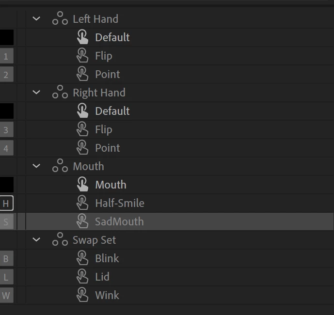

Can you provide a screenshot of the rigging hierarchy -- and ideally the triggers panel to see what triggers and swapsets exist. Trying to understand the nesting you have.
Jan 23, 2022 1:36 AM UTC
Here's the rigging hierarchy (there are a couple more things under the body, I just couldn't scroll all the way.):
And here is the triggers panel:
I really appreciate any help you can give. Thanks!
alank99101739
Jan 23, 2022 4:13 AM UTC
Ah! Smile and Surprised are built in vizemes. Don't put your own expressions inside.
I would create a new group like "MthExpressions" (avoid "mouth" in this layer name!!!) and Put your half-smile as a sibling of Mouth and AltMouth, (and SadMouth?) and have a swap set for Mouth/AltMouth/half smile.
