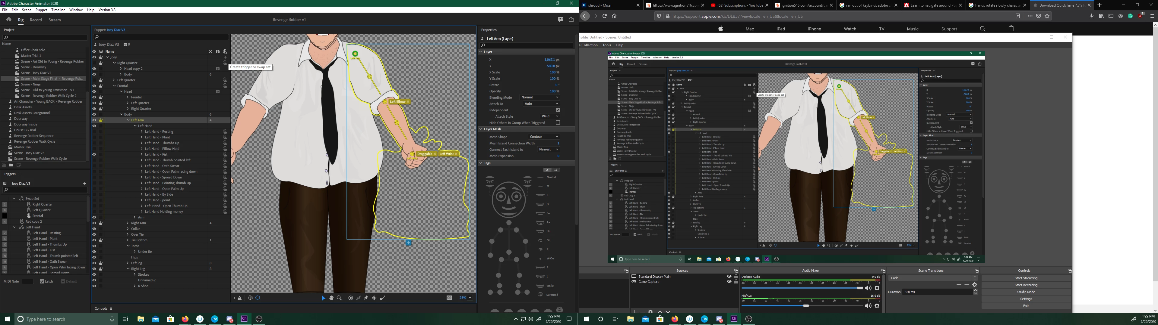

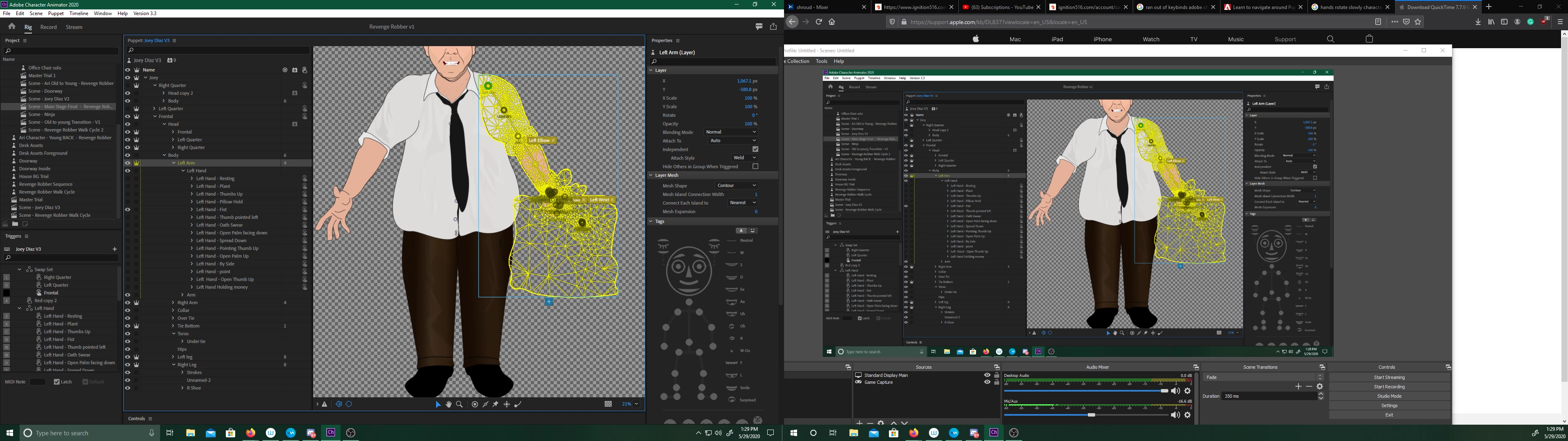

1. My main issue is with the hands of my characters rotating slowly. It is difficult to create pose to pose movement as I am waiting for the previous animation to "finish." See youtube link for example.
I have lots of different triggers/hand positions that I fear might be causing issues. However, I run into the same issue when I duplicate puppet and only use a couple of hand positions. Note: This is happening with all of my puppets.  See screenshots. I don't see any issues in mesh and believe I have rigged correctly.
It's a large project but happy to upload if it helps de-bug.
