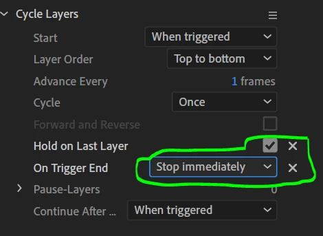

Oh, on the cycle layers make sure you set "hold on last layer" and "on trigger end = stop immeidately"

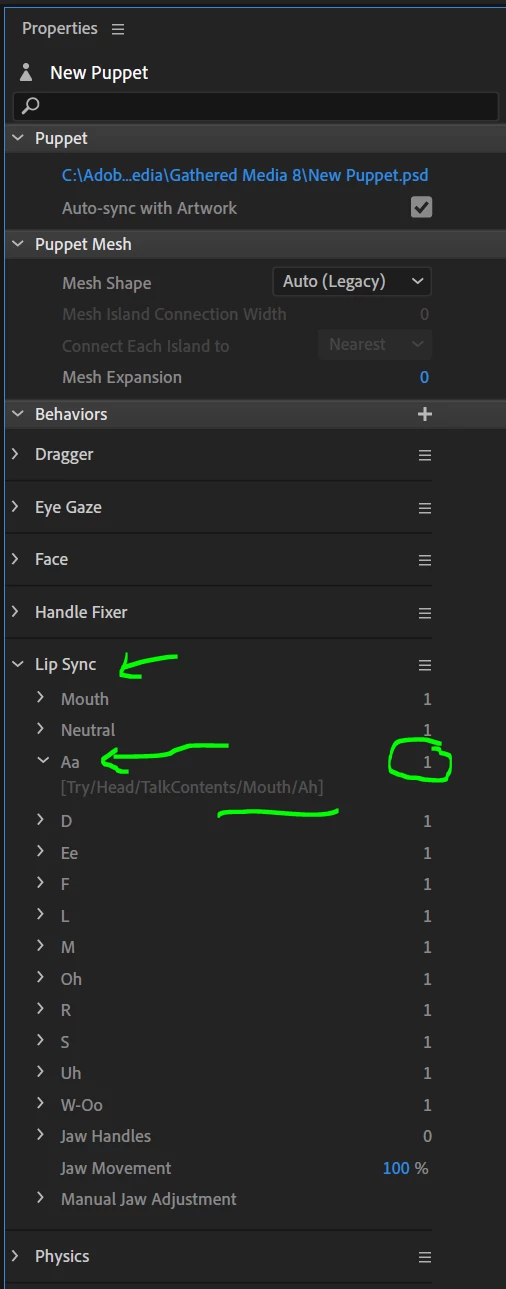

  • I added a LipSync behavior to the "Alt" layer. The root lip sync finds the first mouth but only controls one at a time it seems. So the Alt mouth will need its own. (I check this by looking at the behavior and seeing the layers it binds to. Very useful for debugging.)

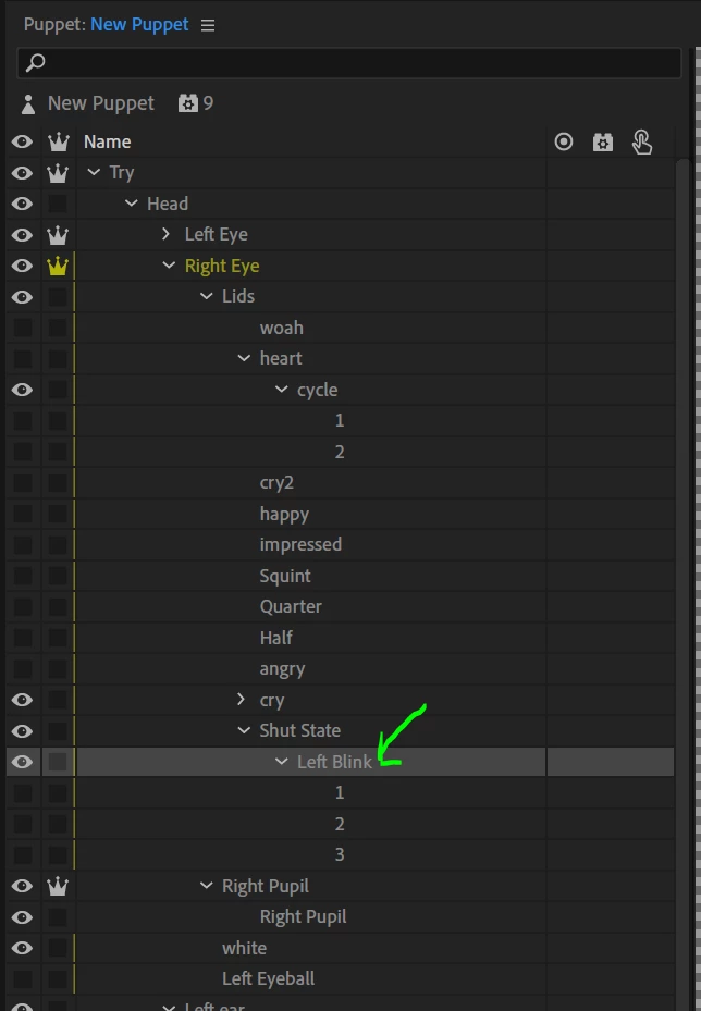

Your right eye has a Left Blink layer, which will cause problems. Rename it to Right Blink and make sure the tags are fixed.

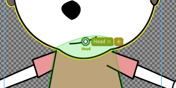

I would seriously consider making the head independent. Do you want it to stretch as you move your head around? Making it independent stops this warping (which I dont think looks good.) Once independent, attach the head origin to the top of the clothes by dragging it. (You want Neck on the Body mesh, not the Head mesh especially if you do this.) Also set the Head Position Strength property of the face behavior to 0 (or 5%) so the head does not drift away from the body.

  • The "Rigging Issues" panel is listing quite a few issues, such as Ah layers not being used. There is also a Left Blink that is not being used. Left Blink has to be an immediate child of Left Eye I think.
  • Don't put "Head" and "Neck" tags on the same point. I find it best to put Neck at the bottom of the neck and Head directly above it. So I removed "Neck" from the Head origin and put another handle on the Body (where you have the shoulder tags). I moved the Head origin up closer to the mouth, and the Neck down lower. This by itself is not enough, but I think it will help.

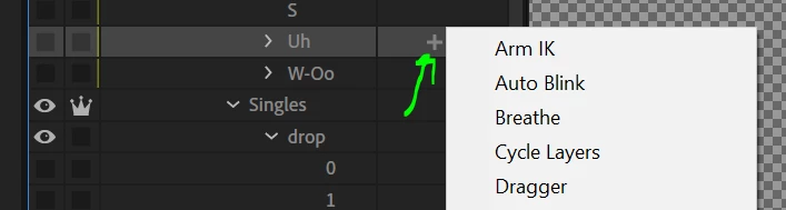

  • You have a few layers with "1", "2" etc as children that I assume are meant to be cycle layers. You need to add a Cycle Layers behavior to the "Ah" layer  (e.g. in TalkContents/Mouth/Ah). Click the "+" in the "lego block" column and pick "Cycle Layers" as the behavior to add.
