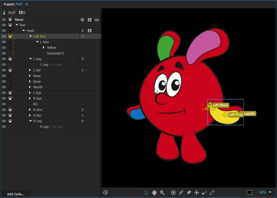

1. Something is wrong with the head movement, since my character doesn't have a "body", you can see that the only thing moving is below its "waist" as if the head is pinned on top.

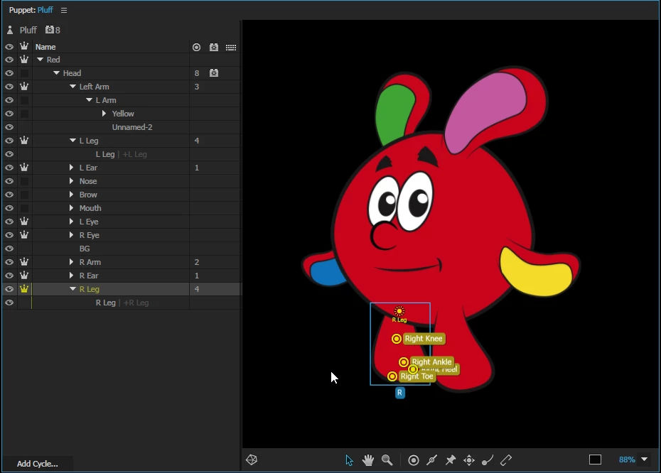

2. The right leg is bending in a odd way, it feels like the character doesn't have any knee, the left leg is fine - guess the problem is that the character isn't on a completly side view?-
3. I can't make the walk behavior work along the puppet arms, apparently I could fix it if the arms and legs strength were tweakeable independtly of each other.

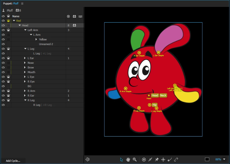

My puppet rig:

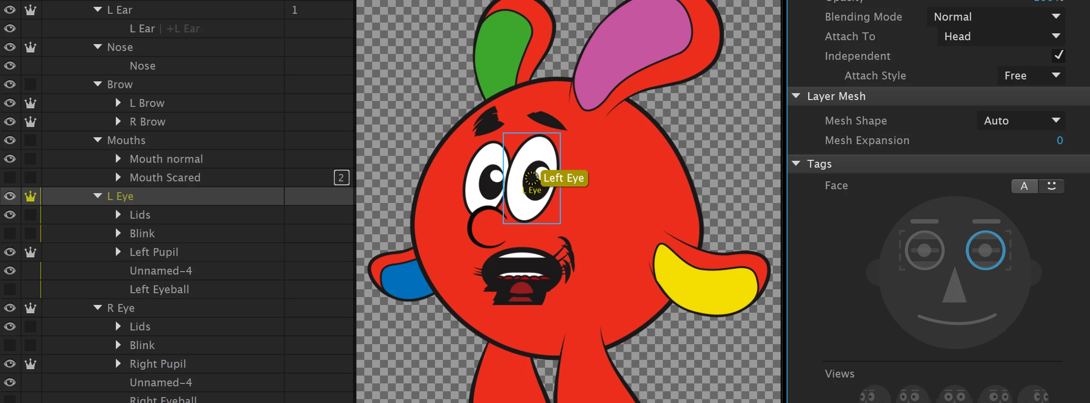

1. The problem is that the eyes are not moving, only the nose.
Make sure your eyes are tagged as eyes - right now I think left and right eye are only tagged as range. It should look like this:
Then the eyes and nose will move (in relation to the mouth). I had to crank parallax way up (700%) to make it obvious.

1. So the issue with head movement is that the head isn't moving along with your webcam face movements? Acquavella at http://okaysamurai.com/puppets/ is also a head-only character but should move along with the head - maybe compare to him to see what differences there might be? And placement of the neck, waist, and hip handles can have a dramatic effect on where the bends happen - experimenting with them can often bring very different results (the limbs and body are looking at the three of those as foundational elements to works against). I didn't see a waist tag, maybe that could help?
2. Experimenting with placement of the leg handles should help this - adding sticks to the calf and thigh could also help define the knee more. And again, placement of waist and hip could affect these too.
3. Yes, because this is more of a 3/4 view, the arms are going to run into issues because they're not directly over the legs - I've had the same thing happen with my characters.  Right now the walk just isn't optimized for non-profile characters.
