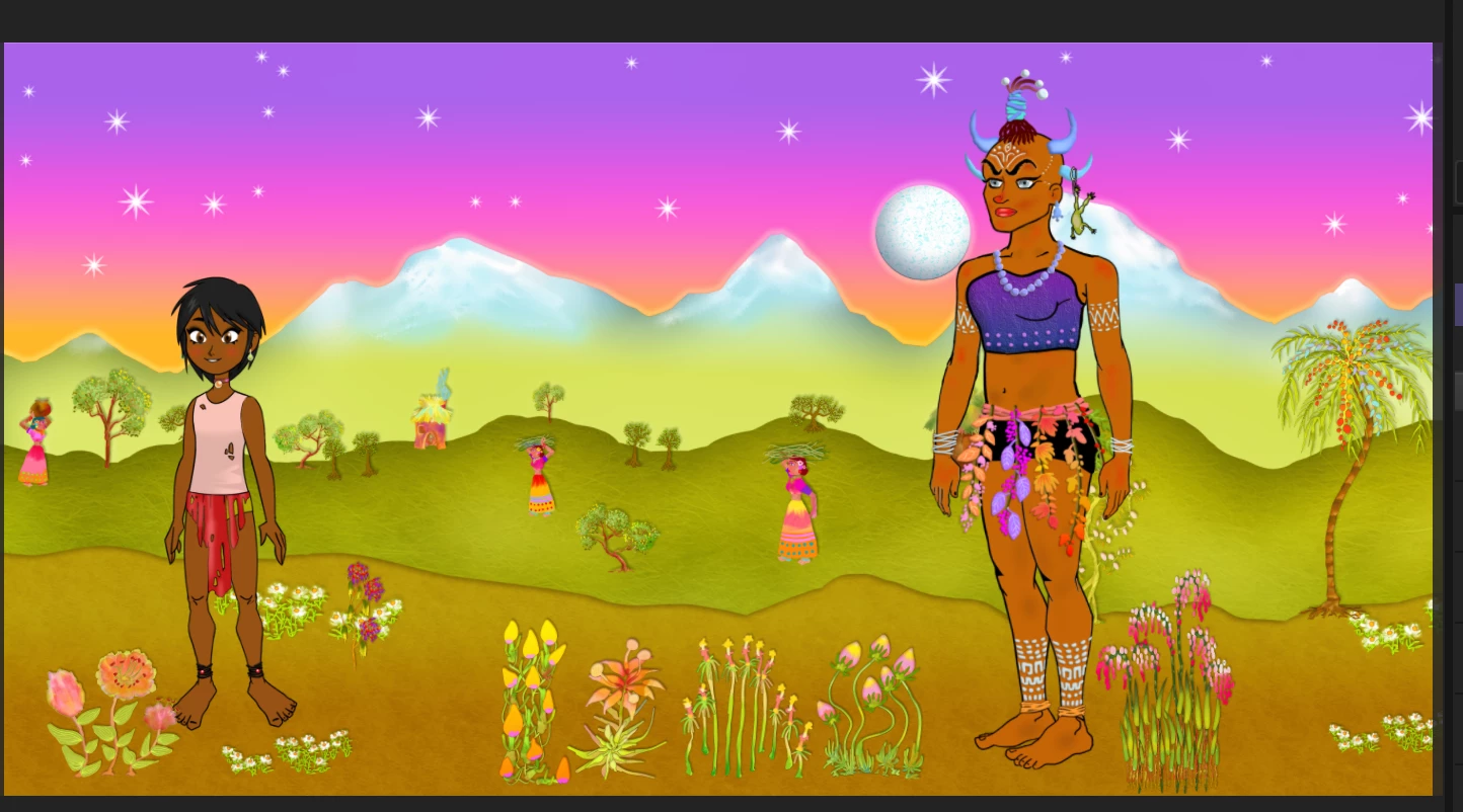

  1. Screenshot of the Scene with the Puppets Stationary.

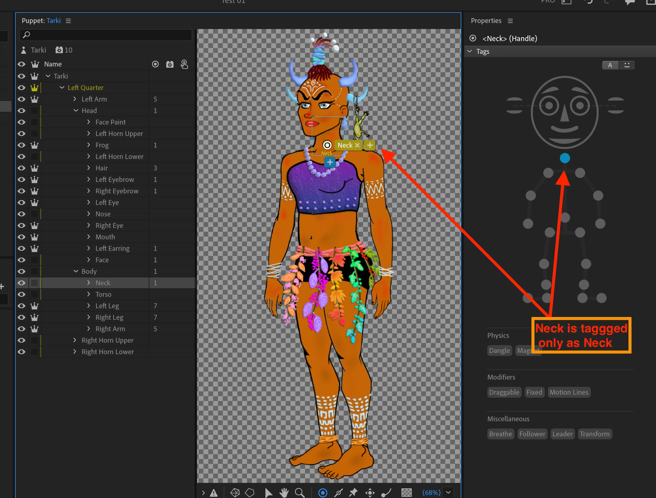

  3.  Puppet's Neck Tagging.

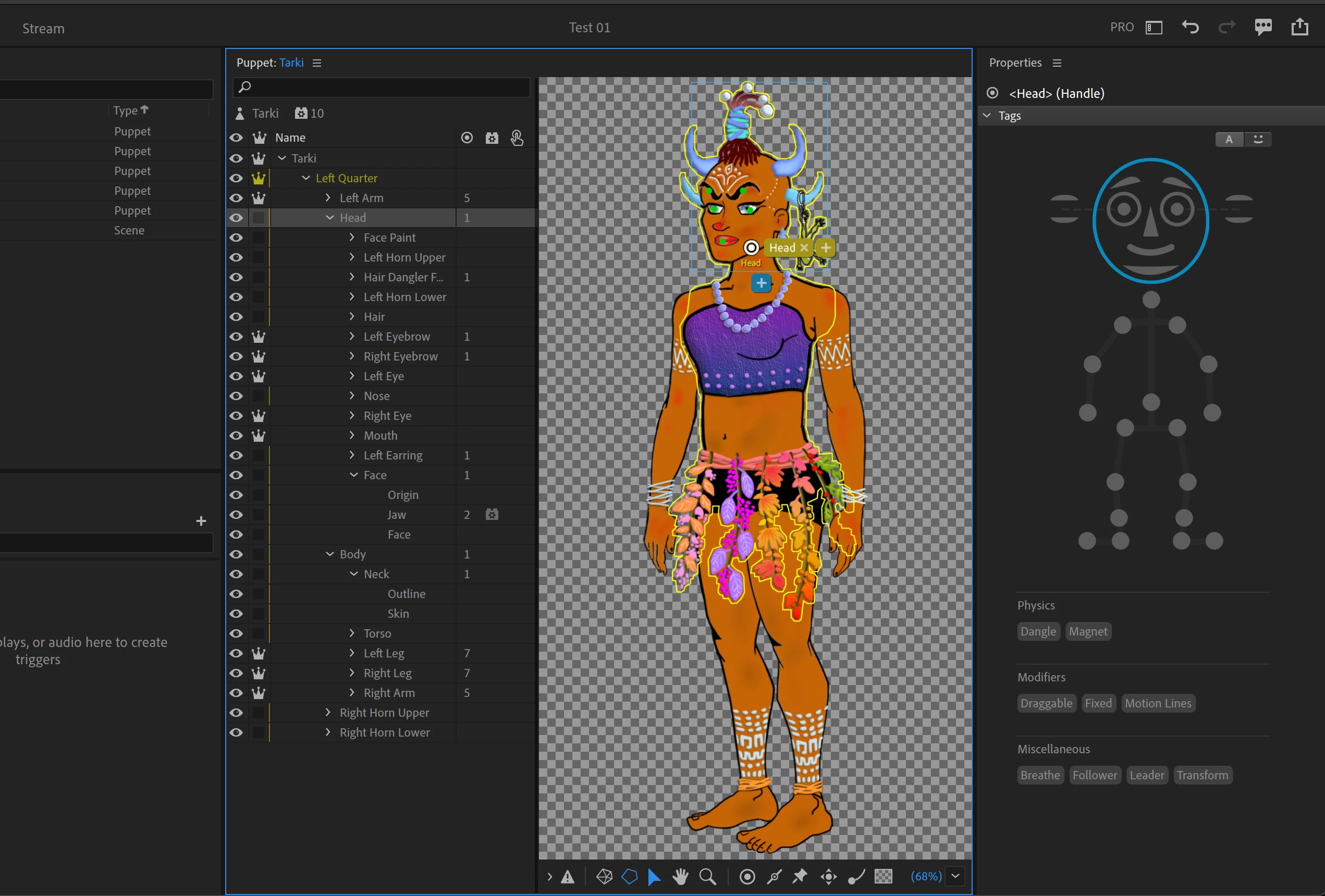

  4.  Puppet's Head Tagging.

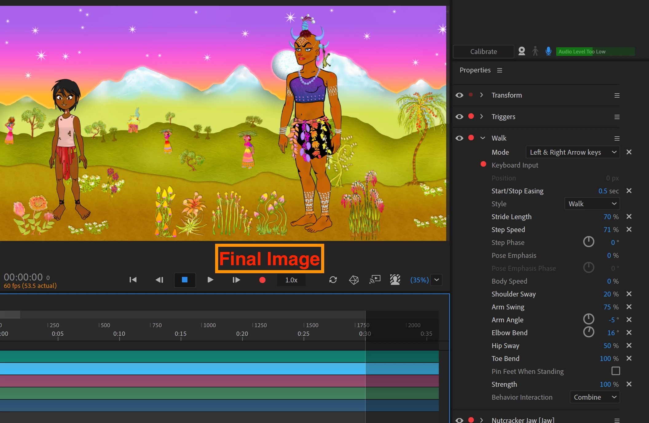

R_Domalpalli
Mar 5, 2023 1:46 PM UTC
Thank you for your clear instructions, K_Oshiro. They fixed the problem.
I've attached a Recording of the final Walk Cycle.
The Image with Stationary Puppets looks like this:

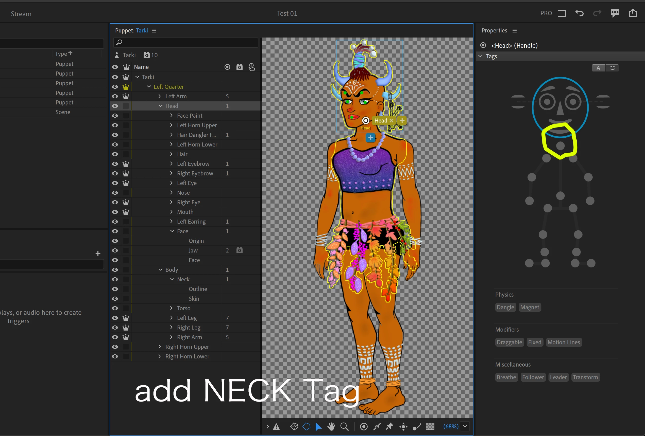

k_oshiro
Mar 4, 2023 4:36 PM UTC
Try adding the neck tag to the same handle as the head tag.
Thank You.

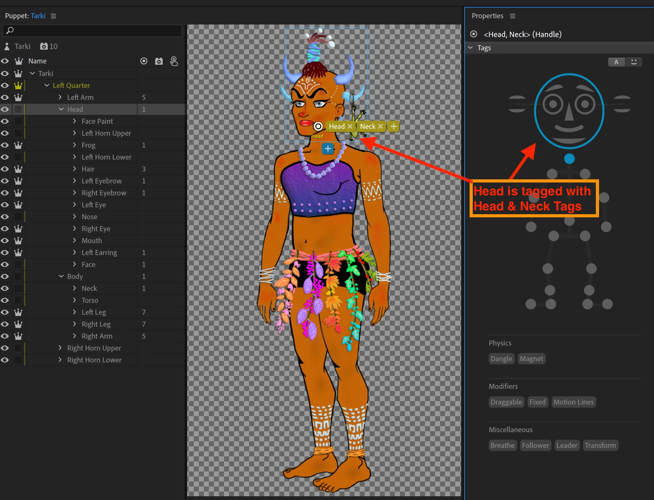

R_Domalpalli
Mar 4, 2023 6:24 PM UTC
Thank you for writing back, K_Oshiro.
I tagged the Head with both "Head" & "Neck" Tags and tried it again. The Neck is still tagged as "Neck". However, the Problem still exists.
I've included/ attached 5 files:

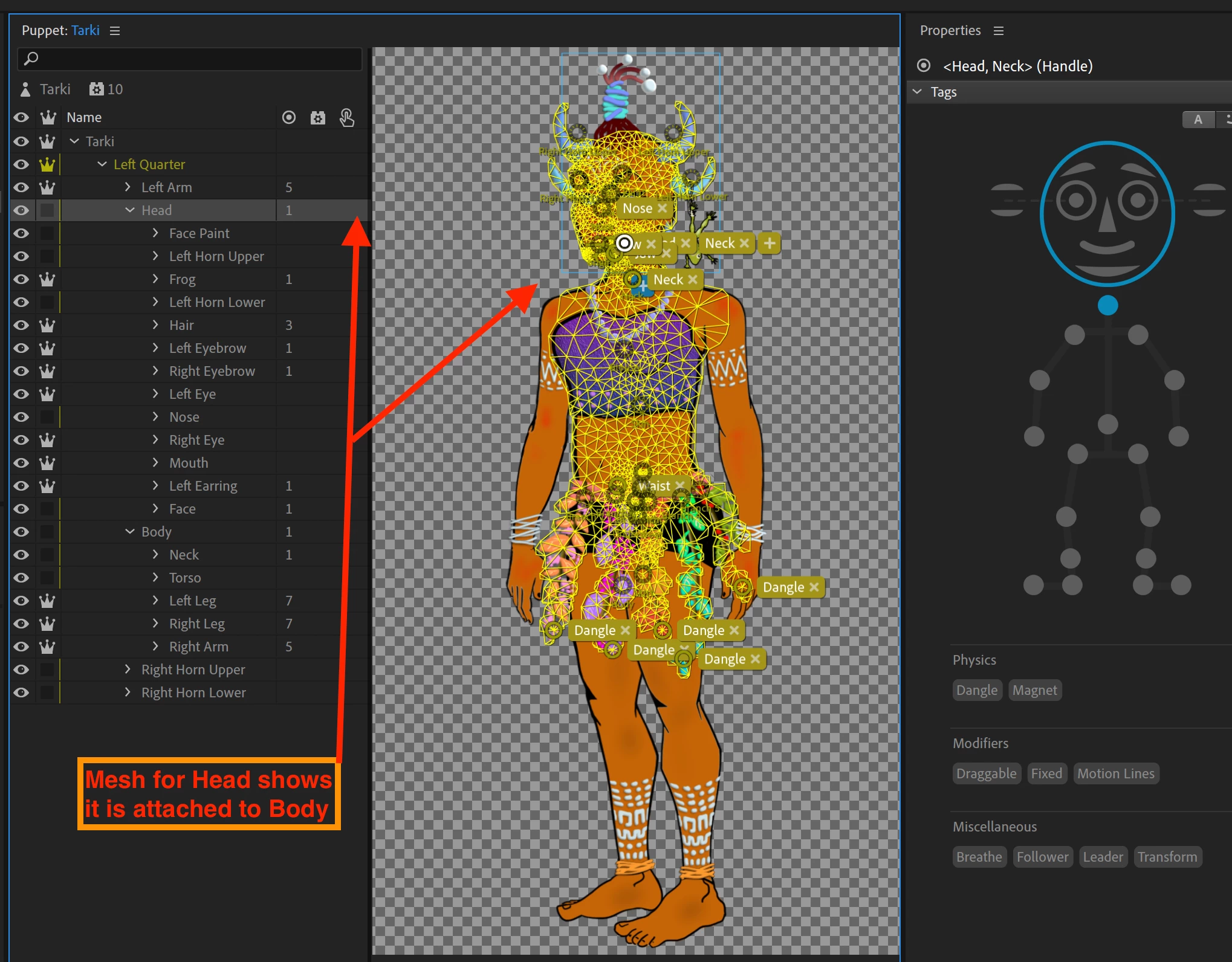

  1.  Screenshot of Head Tagged as "Head" & "Neck" (See Below):
  2.  Screenshot of Head Mesh shows attached to Neck and Body (See Below):

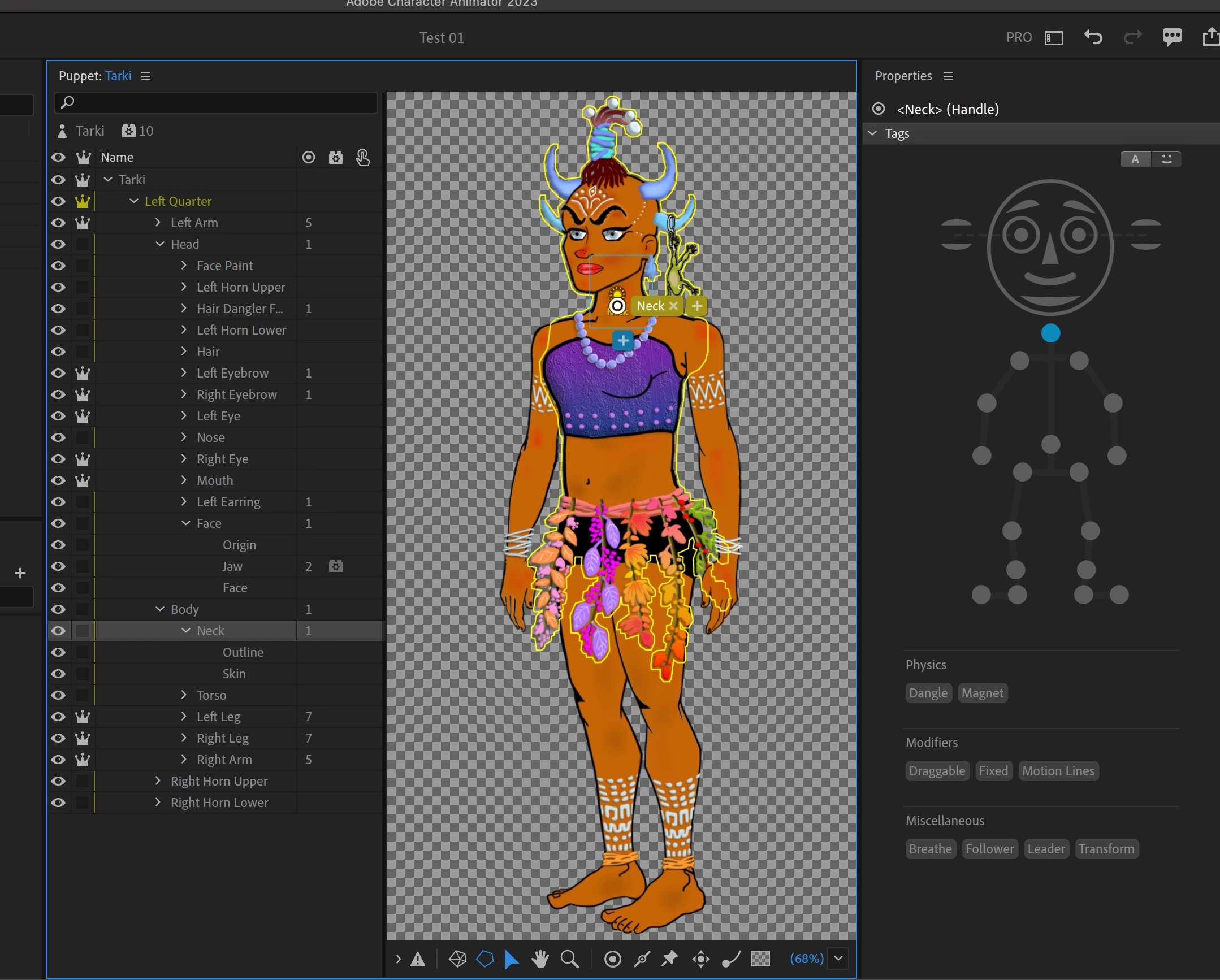

3. Neck shows it is tagged only as "Neck" (See Below):

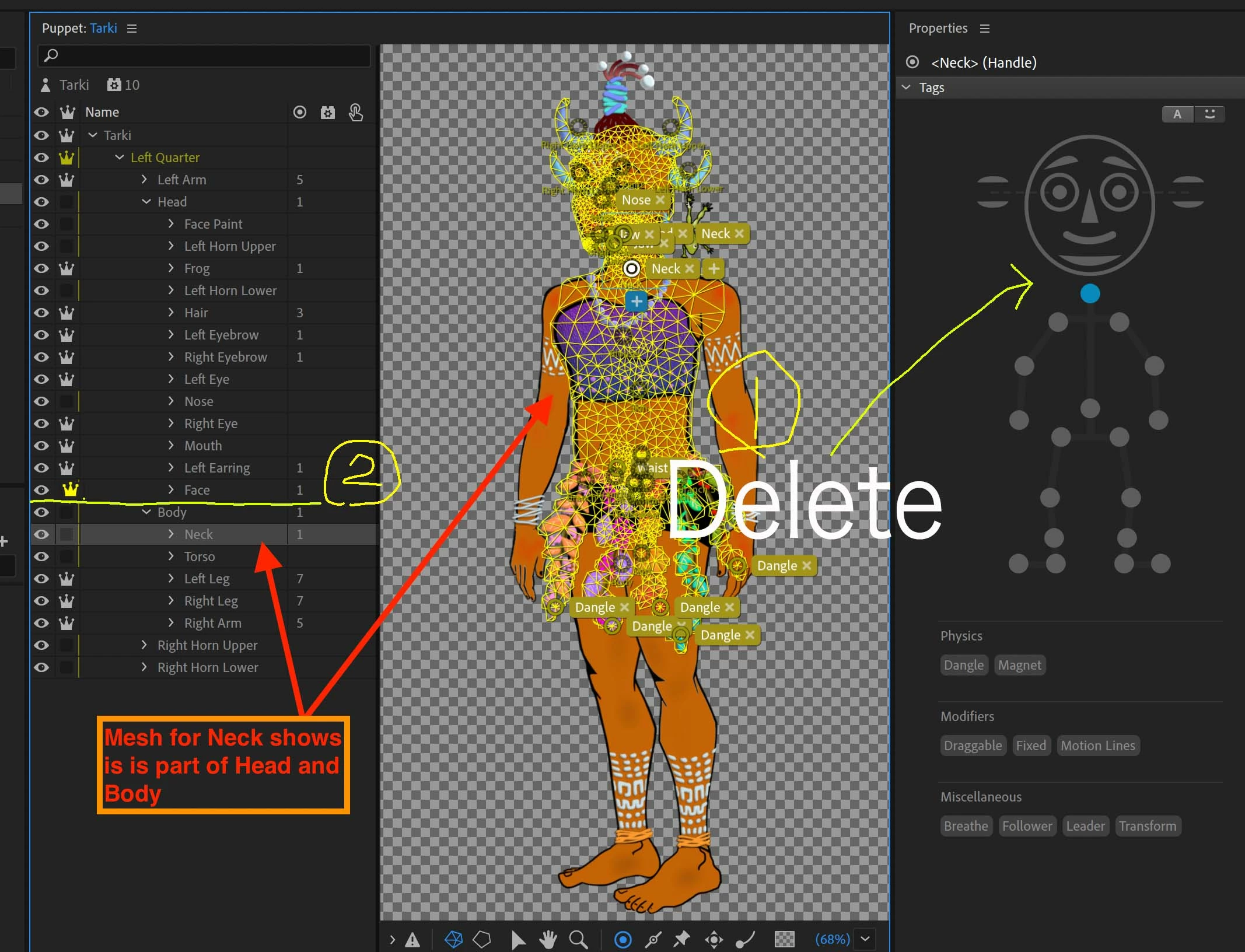

4.  Neck Mesh shows it is attached to Head and Body (See Below):
5. Attached Recording showing that the Problem is still there.
Any suggestions on how to fix this?
