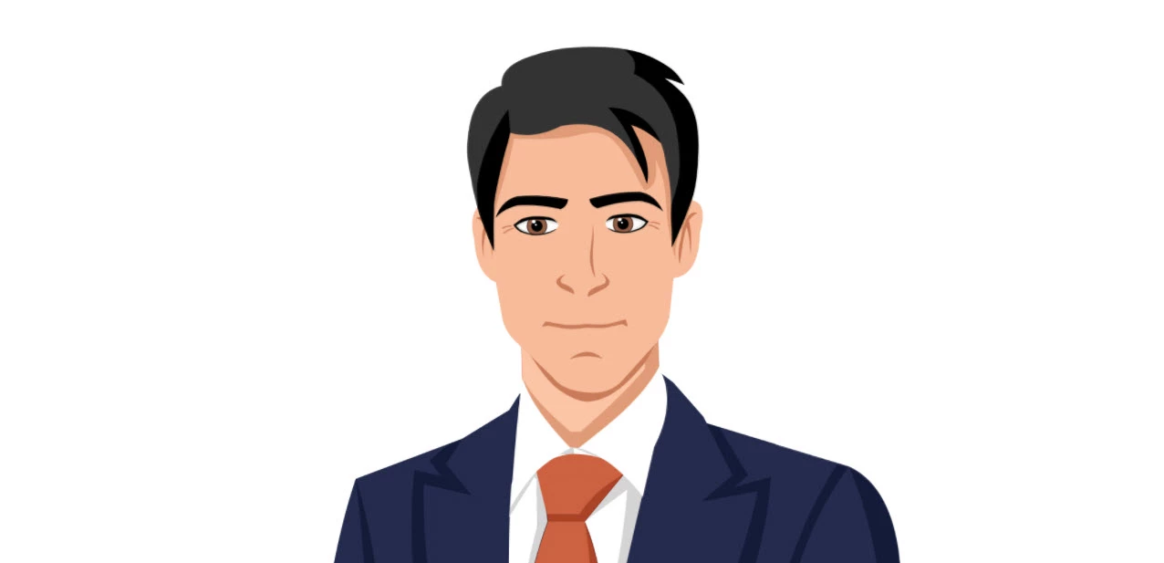

Hello there!
My puppet's face is distorting in weird ways whenever I try to integrate head turns. I've compared the files to some example puppets and I haven't figured out what I'm doing wrong. I even tried applying the Face behavior to each head view group, but no luck.
Here's what the front view looks like:

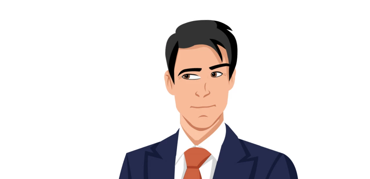

And here's what the head turn looks like:
It's supposed to just be a slight nudging of the facial features. I think something is going wrong with the face tracking that's causing all the features to stretch when I move my head. Any ideas what the problem might be?

In every view you have a layer called "head base" which is getting automatically tagged as a Head, causing issues (CH thinks you have a ton of heads when really all you want is 1). If you rename that layer and/or remove that tag it should be reliable.

Yup, you were right on the money! It's working fine now. Thank you for the speedy response!
