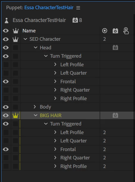

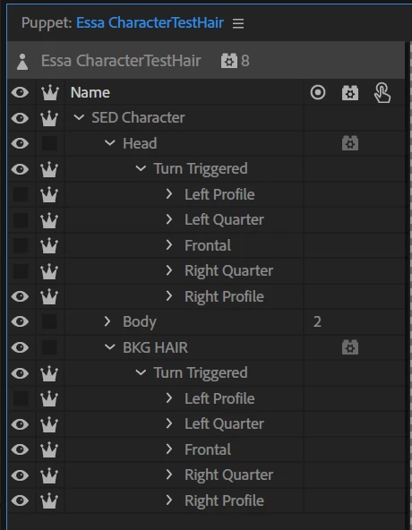

    I turned off lots of independence you had (because it causes problems with rear hair). I then turned on independence on BKG HAIR and added dangles to the rear hair. (Without this, the bobbing hair would distort the head as well.)
    BEFORE:
    AFTER
    For BKG HAIR I also set the attachment to AUTO and so the BKG HAIR ground is attached to the puppet root, which includes Head and all turns because they are not independent. If you need Head independent, this will stop working.
    The hair bounces a bit too much for my liking, but I think that is a Character Animator v1.5 bug. The physics strength for stiffness in bounce does not seem to work as far as I can tell.
