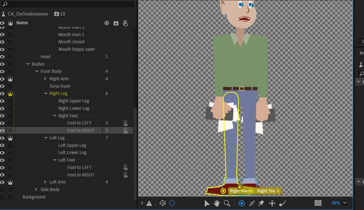

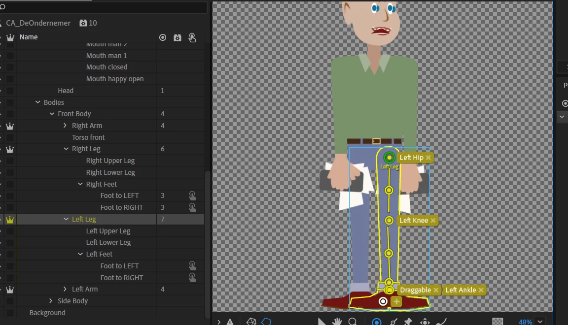

Heels are pinned to the ground with Limb IK? Visual error for mirroring feet
Here is my issue. I am creating this rig and for some reason after I activate Limbs IK, the heel AND toe points are stuck to the ground and I get this weird distortion if I drag my draggable.
Here is my setup:
I am not sure how to handle the fact that I have two different feet directions. Maybe that's what is messing something up. But I need to have one puppet who can turn his feet both ways (mirroring).
Any advice is much appreciated, thank you.
Also as a second question, is there any handler for easy rotation of hands etc. in the Scene editor? What's the best way to go about to animate hands and feet rotation?

Dec 18, 2020 10:47 AM UTC
I notice you have handles done differently on the left and right legs. Eg there are 3 handles on the two triggers for the right foot, but none on the left leg. I am wondering if the extra handles on both triggers are causing a problem. Normally you have a different profile for walking left and right rather than just swapping the foot - eg somewhere higher up in the hierarchy you have a Left Profile and a Right Profile layer, with a Standing profile for facing forward. I would have a look at some of the walk tutorial videos. What you are doing is an int4resting idea though... it's just i think the handles do not go away just because a layer is not triggered, so your right foot has two sets of tags for the same concepts, as far as ch is concerned, which gets it confused. That is not happening on the left foot - but it will get the toe wrong when walking the other direction.
k_oshiro
Dec 18, 2020 10:32 AM UTC
I used translation software to translate Japanese into English.
I tried to make a puppet that I think you would like.
(1) I used ”Limb IK" for the arms and legs.
(2) You can change the direction of the legs by pressing 1 and 2 on the keyboard.
However, I didn't see any symptoms in your puppet.
Can you upload your puppet to dropbox or something?
A closer look at your puppet might help.
Thank you.
Video explanation (Japanese)
https://youtu.be/iNrVUVs6kQI
You can download my puppet here.
https://www.dropbox.com/s/t8mc9ga3iroq77c/Limb_IK_sample.puppet?dl=0
