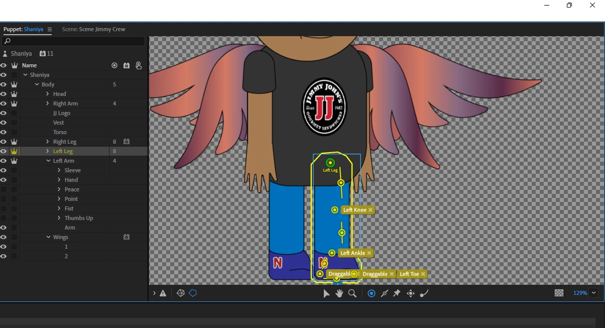

I see two draggable handles on your puppet's foot. One should be sufficient.

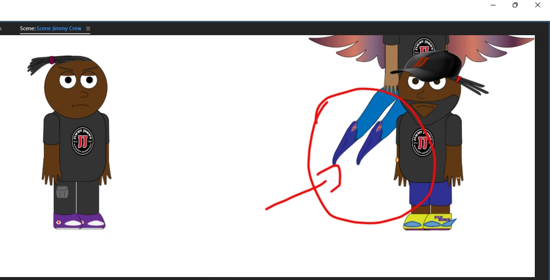

Thanks for the replay. I didnt realize I had left two draggables. But even still, the toes or heels stay pinned to thte ground when I drag a foot or the boddy into the air.

So, to be clear, you have a puppet with a draggable handle elsewhere? What layer is it on? I am trying to duplicate your problem and when I drag my puppet, the rest of it moves as expected. I've found that moving the heel handle to where the ankle would be and making that dragable seems to keep the feet from getting distorted.
