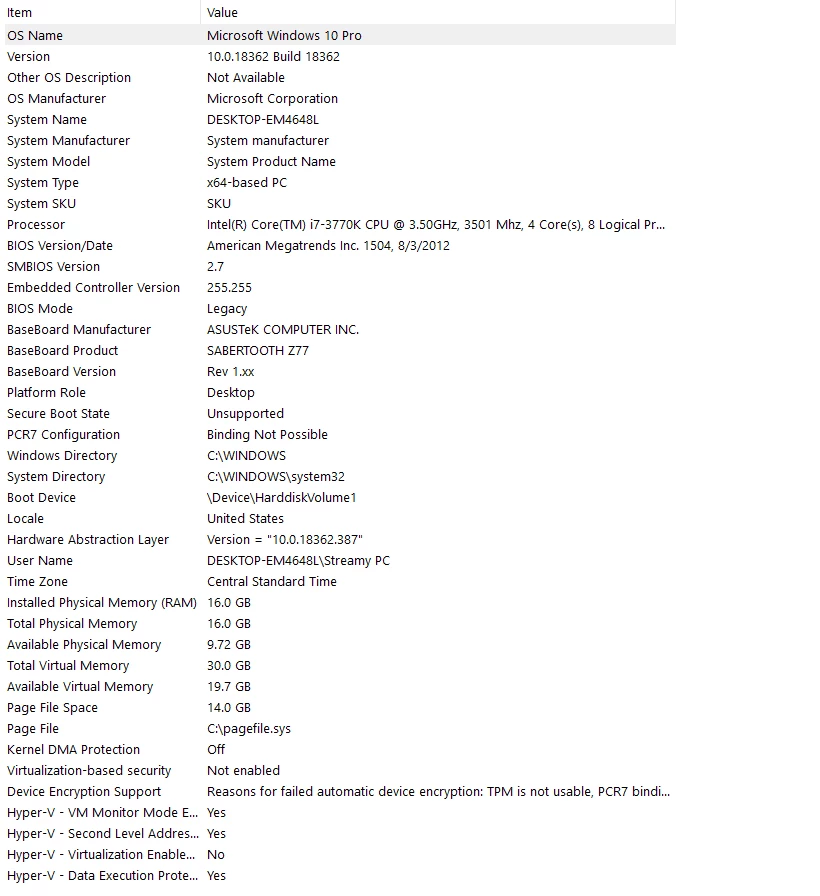

David ArborCorrect answer
Nov 8, 2019 9:09 PM UTC
Y'know, I didn't read your specs properly. Yes, your processor is from 2012, a new computer will make this process significantly faster. I'd also get 32 GB of RAM and a decent, but not super expensive GPU. SSDs are faster to work off of than HDDs. A good setup is to have a fast SSD for your OS and applications, another fast SSD for your project files, then a spinning HDD that's larger, but slower for archiving or backups.

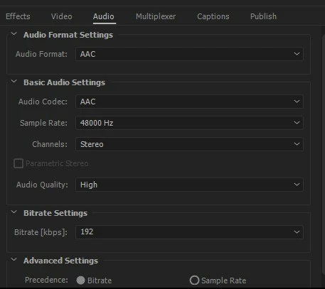

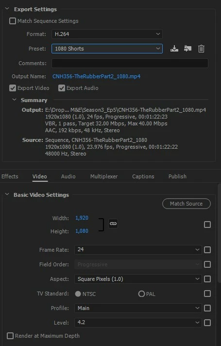

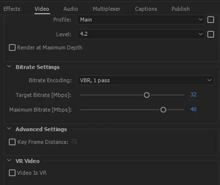

paulb27964210
Nov 8, 2019 8:12 PM UTC
Hey Dave!
The settings we're using through Media Encoder are thus:
I believe the frame size is 1920 x 1080, and the frame rate is 24FPS

paulb27964210
Nov 8, 2019 4:17 PM UTC
Here are the specs for the computer were using, if there are any obvious upgrades needed please let me know!
