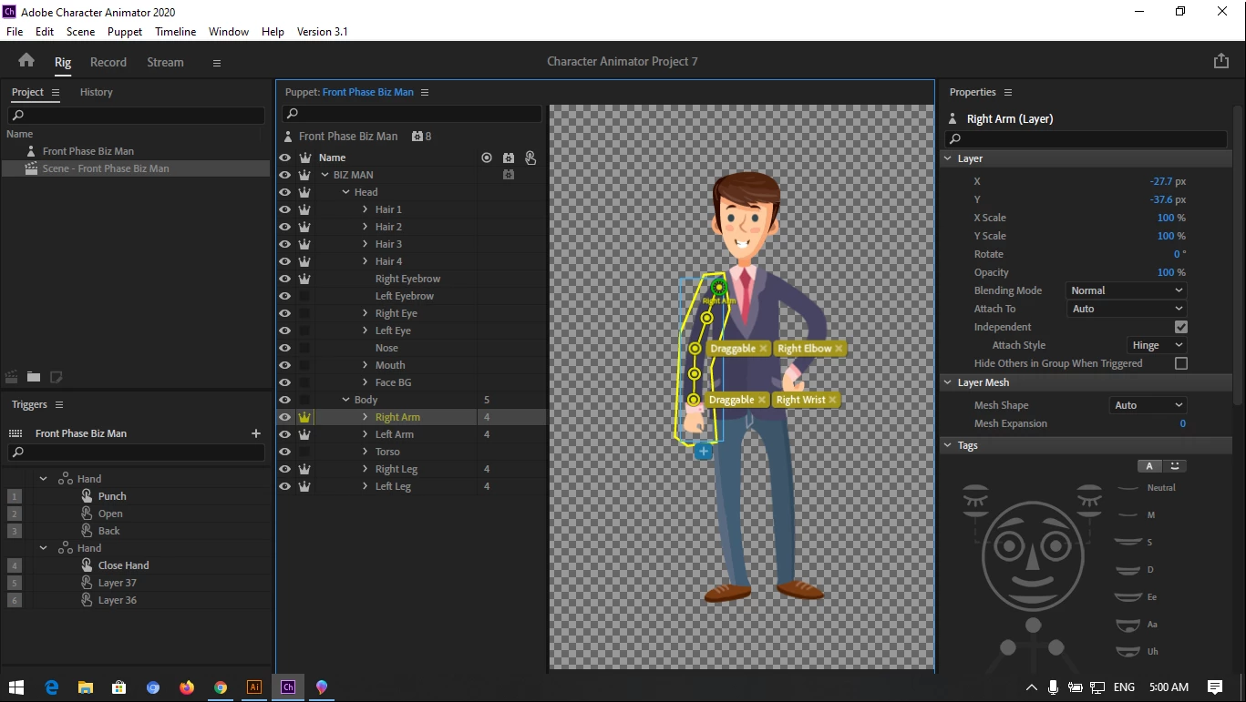

Hi everyone, I have a head problem with a jump for my puppet
I need to know that when I want my puppet is jumping, I have to make the head independent so once I apply it, I find both the head, the neck are flying above the body. However, please consider that I did use the draggable for waist legs and hands, but I still don't know how to fix, I believe that I have something wrong with but I don't know where  I'm trying to figure it out for a week without any positive progress!!!
So please, guys try to help me out.
Thanks
See attached

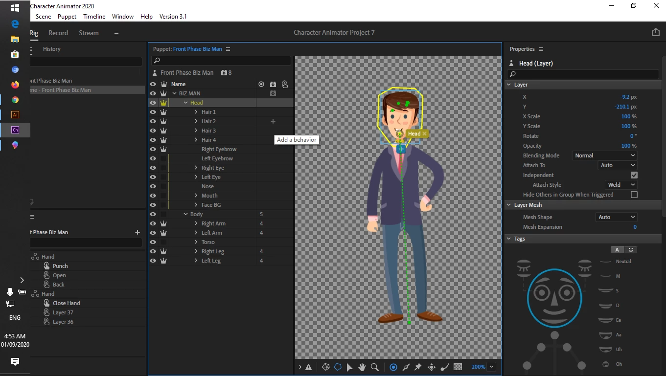

Oh, one thing I just noticed, the origin handle for the head is not positioned to attach the head to the body. See how it is yellow but the arms are green?
because you have the neck a part of the head, the origin handle will have to be moved down to overlap the torso. It must turn green to indicate attachment.
Personally, I normally draw the neck as part of the torso and make it go up behind the head. Then I attack the head to the neck. You can make the neck a part of the head instead, but then you need to attach the head to the body between the shoulders
Sep 1, 2020 3:51 PM UTC
Thank you again for your help
I fixed, and now the original handle of the head is coloured by green but unfortunately, the head still positioning away from the body.
What do you think to make more, any more suggestions?!!

Try adjusting "Head Position Strength" of the Face behavior to zero and see if that fixes it.
Sep 1, 2020 12:15 PM UTC
Thank you for your response, I already did it, but nothing has changed!!
