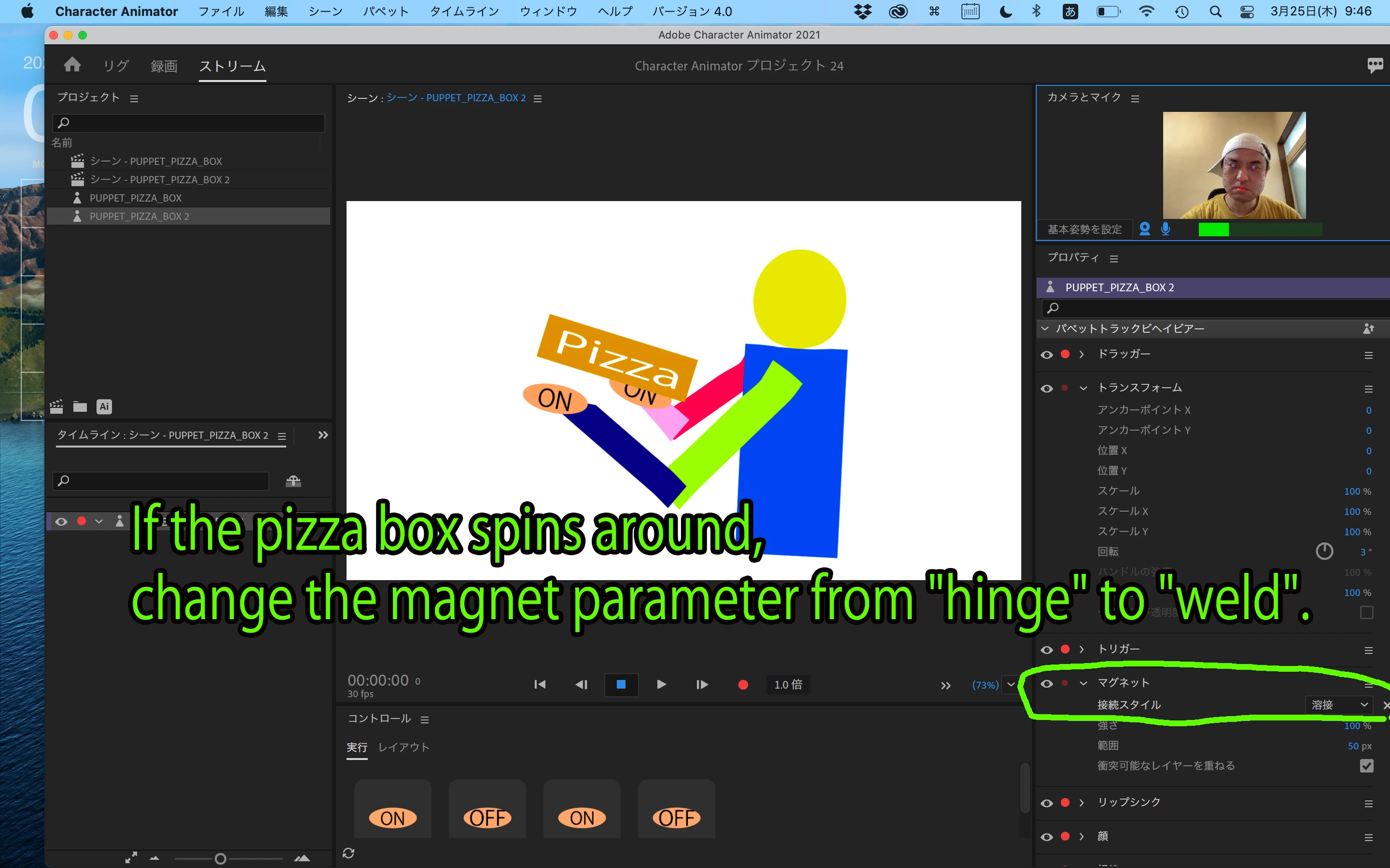

I have a character that i want to make him hold a pizza box with both hands. But i can not do it, when i put the magnet on the boxes and another magnet to the guys hand, the pizza box doesn't stay still and it starts rotating, when i put two magnets to the sides of pizza box and put magnets to both hands of my character it doesn't work eighter. (It kinda throws to a far place) what can i do about that?

See the articles I posted in the past for techniques to move both arms at the same time.
https://community.adobe.com/t5/character-animator/moving-both-arms-at-once/m-p/11629448
This case is a combination of magnet behavior.
If the pizza box spins around, change the magnet parameter from "hinge" to "weld".
The program is a little complicated.
But it is possible.
It's difficult to explain in English, so
I uploaded a sample puppet to Dropbox.
https://www.dropbox.com/s/glijt476b3xpz6j/fix_PUPPET_PIZZA_BOX%202.puppet?dl=0
A brief commentary has been uploaded to YouTube.
https://youtu.be/KR35b3mEFA0
※The magnet is turned off by pressing the keyboard key "1".
I hope it will be helpful.Thank You.

You cannot have an object with two parents to my knowledge - so you need to think of tricks like having one "arm" contains the artwork of two arms but with transparent filler between them, the the pizza is attached to that one arm. You might put it in a swap set so yiu use the two normal arms or the two-hands-holding-pizza-single-funky-arm.
