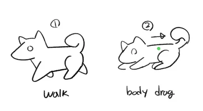

I'm making dog puppet and wanna rigging now but having hard time to walk and drag my puppet @-@@
for dog walking I referred to the two videos
https://www.youtube.com/watch?v=nwahIPo8Nm0
https://www.youtube.com/watch?v=62NroCgZJKM

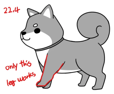

in 23.1 version if i add limb ik, walking looks weird but dragginf works well
and when i close eye of limb ik or remove that, walking looks good but dragging is like moving a wooden board.. haha. when drag, I want dog's feet to be on the floor.
so i downgrade version to 22.4 bcz i had dragging issue with 22.4+ version before.
in 22.4 only 1 leg working well... xD
i don't know what i miss now.. can any help me?
i just wanna do walking and dragfing at once

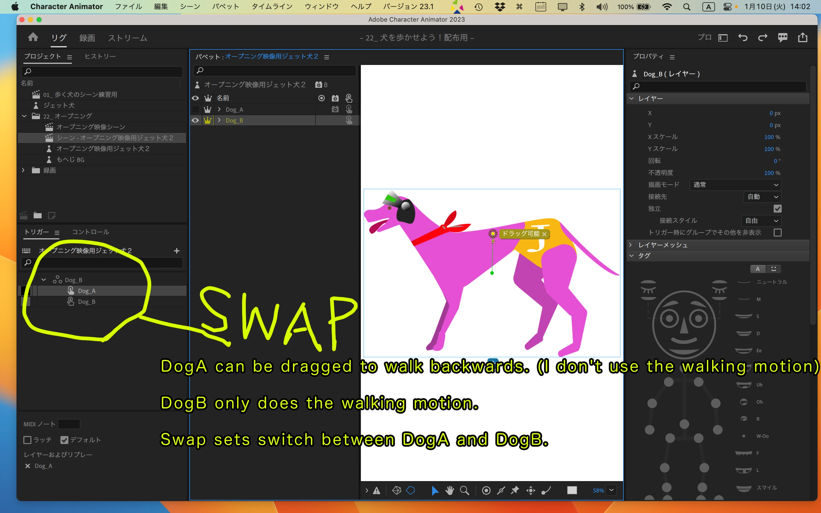

It's hard to make one puppet stop and walk.
How about using a swap set as one idea?
DogA can be dragged to walk backwards. (I don't use the walking motion)
DogB only does the walking motion.
Swap sets switch between DogA and DogB.
Thanks.
I have uploaded the sample files to GoogleDrive.
Keyboard key 1.
https://drive.google.com/file/d/1wdD34g80kZYh5jlQ3Uj4xwvoo8nwK6Sn/view?usp=sharing
YouTube Japanese
https://youtu.be/tGf1edB9zOA
Please refer to it.
Thanks.

k_oshiroCommunity ExpertCorrect answer
Jan 10, 2023 5:21 AM UTC
I used Japanese to English translation software.
Thanks for referring to my YouTube video.
Thanks.
Keyboard key 1.
YouTube Japanese
Please refer to it.
Thanks.
The file you uploaded to G-Drive could not be loaded.
Sorry.
