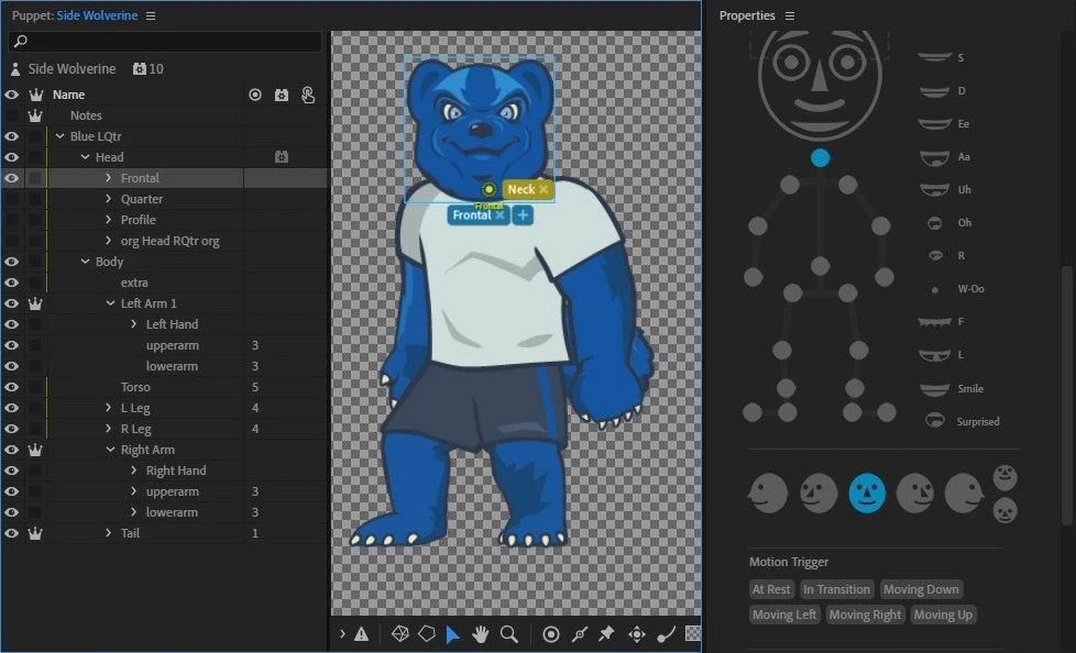

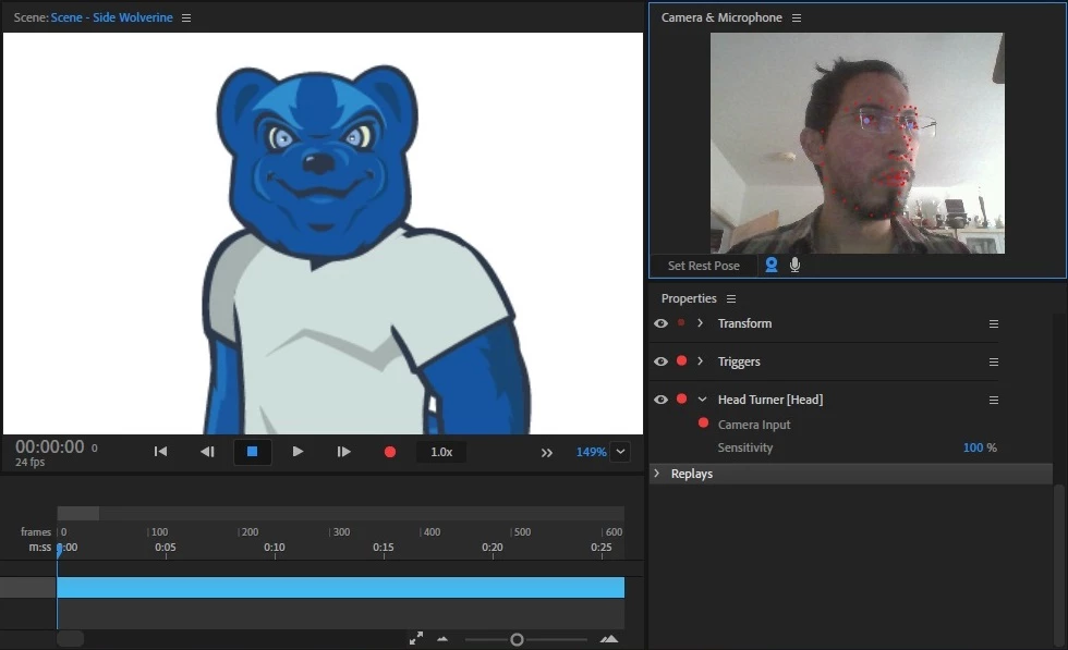

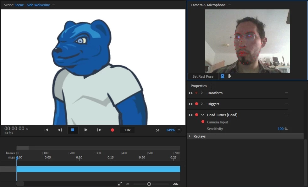

I've used the swap set previously, but when I set my Frontal layer as default it just kept Frontal visible while continuing to do whatever funky nonsense it was doing by keeping my Quarter position as the default then switching as I turned my head.

Are your heads tagged correctly on the right side? I can see from your first screenshot that your Frontal group is tagged as "Frontal" on the right, but what about the others? Also, do you have any manual triggers that could be conflicting here?
If you expand the Head Turner behavior in the Rigging workspace you can see all the groups assigned to each head turn pose; see if that gives you any clues.
And lastly, you don't have to have the Head Turner behavior on the Head layer itself, so if none of the above help, remove that behavior and move it to the top-level puppet, just to see what happens.
