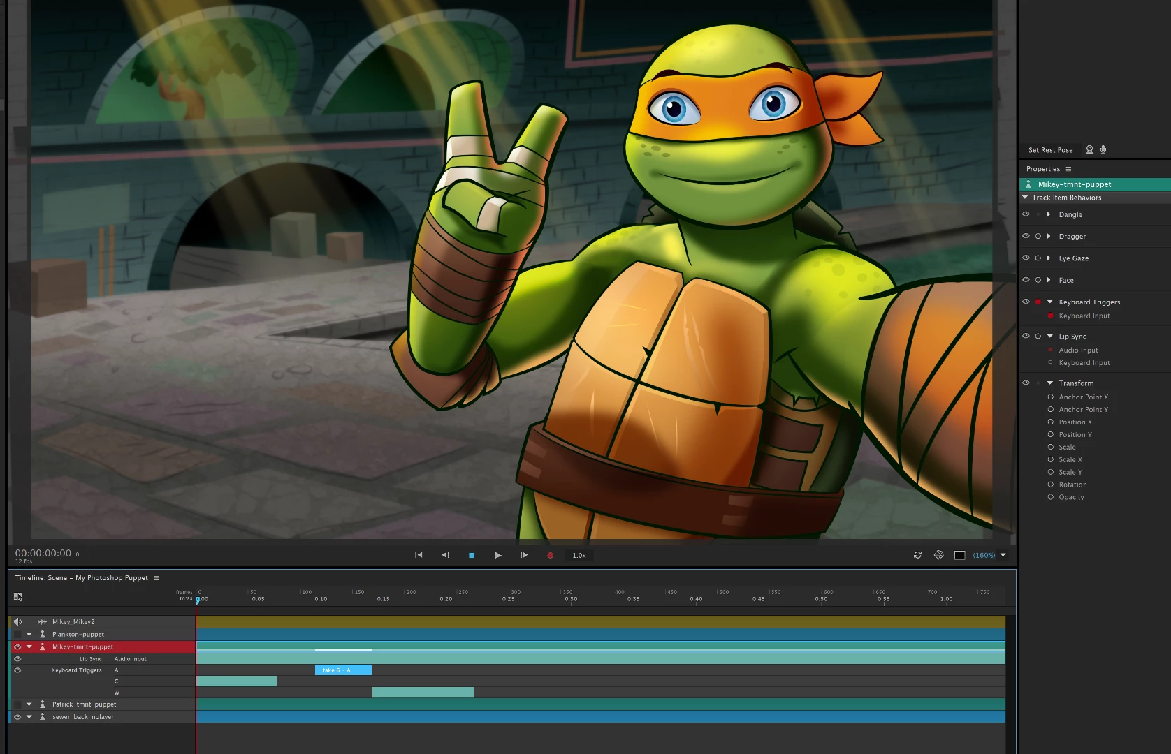

Okay, I have another question on here that hopefully gets through even though I marked the question answered.  I got the different mouths and emotions to work with the "compute lip sync" thing, but I have a new need/question.  I have a handful of emotions and I want to be able to fine tune where they come in at and how long they last.  In the screenshot, you can see the "keyboard triggers A, C, W."  I tried shrinking the length of the keys and moving their boxes around (like you can see there) but that didn't really seem to do anything.
So can I do the key triggers manually in the timeline and tweak them instead of recording them live on the fly?
El Wombat
Aug 8, 2017 11:29 AM UTC
Hi Rocky,
I had a similar task at hand the other day and I think:
a) Yes, you can, but…
b) it's a bit tricky because the bars show only that there is activity for that specific trigger, not which: on or off.
I think a possible workaround is to set the default position to another trigger (normally, you don't do that for "default" layers or groups…) and that way you would be able to just turn "on" with a key, then another with a different key "on" that overrides the former, and so on. And with bars that show only one kind of activity you can then finetune.
I *think* that was how I solved my similar issue… Hope this helps.
