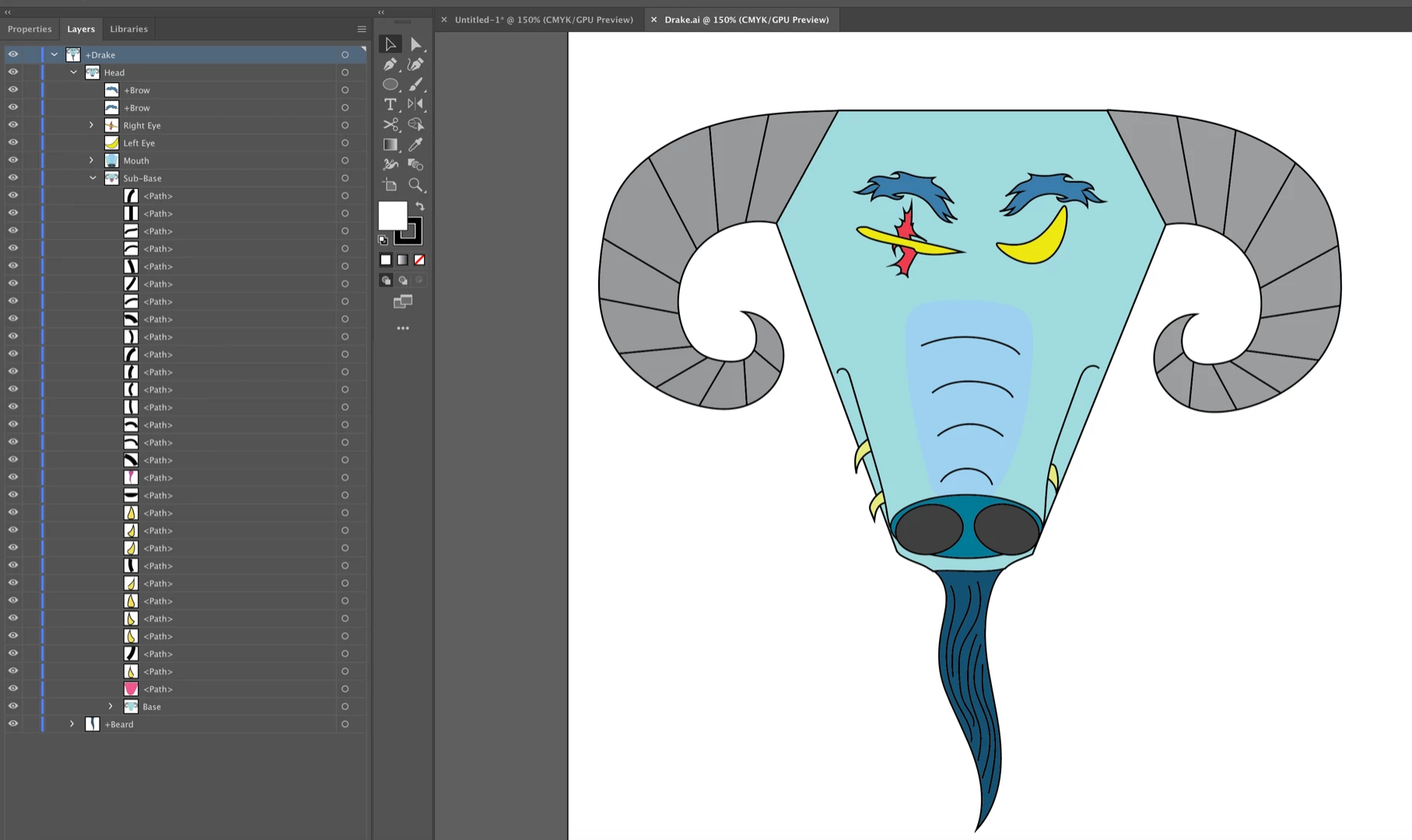

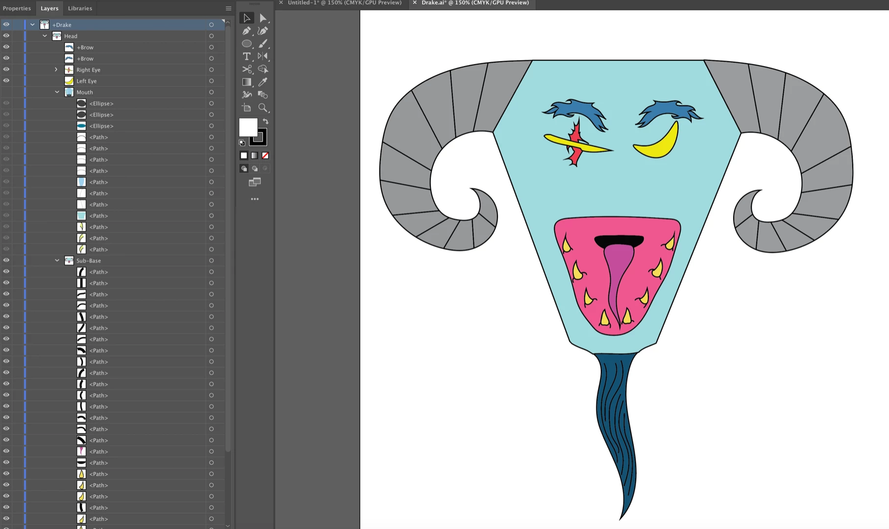

My character is the head of a drake (dragon, wyrm, wyvern, whatever you want to call it). I made the base layer of the head with the lower jaw as a static image and the upper jaw/maw a separate layer. I simply wanted to have the upper portion bend/warp/whatever as I open my mouth for the camera.
Is this even feasible? Did I instead need to make the upper jaw/maw the base and have the lower jaw as a separate layer to extend outwards as my chin dropped on-camera? Did I need to limit mouth movements and try to use subtle shapes underneath the upper portion to convey tone and other cues of language/expression?
Was Character Animator simply not designed to handle this kind of (semi)complex facial recognition and I should stick to traditionally humanoid-esque mouth patterns? Are creatures mostly just limited to brow expressions and maybe slight eyelid manipulation?
If possible, is there a way to upload the puppet file from Adobe Illustrator so that someone can look at what I have done and infer what and how I originally intended to make this?

    My intention was, if the nutcracker thing was not necessarily the method I SHOULD have went for and built accordingly (turns out, I'll have to re-arrange some things so that YES I need to), imagine a gripping point on the end of the snout. From said point, it lifting upwards and using the Z-axis so that it basically all "flattened out" at roughly 90-degrees of lift.
    But looking back at that, it probably would have looked rather silly and broken since there'd be no thickness to the layer to add to the illusion.
    Nutcracker re-design is the way to go, I guess!
