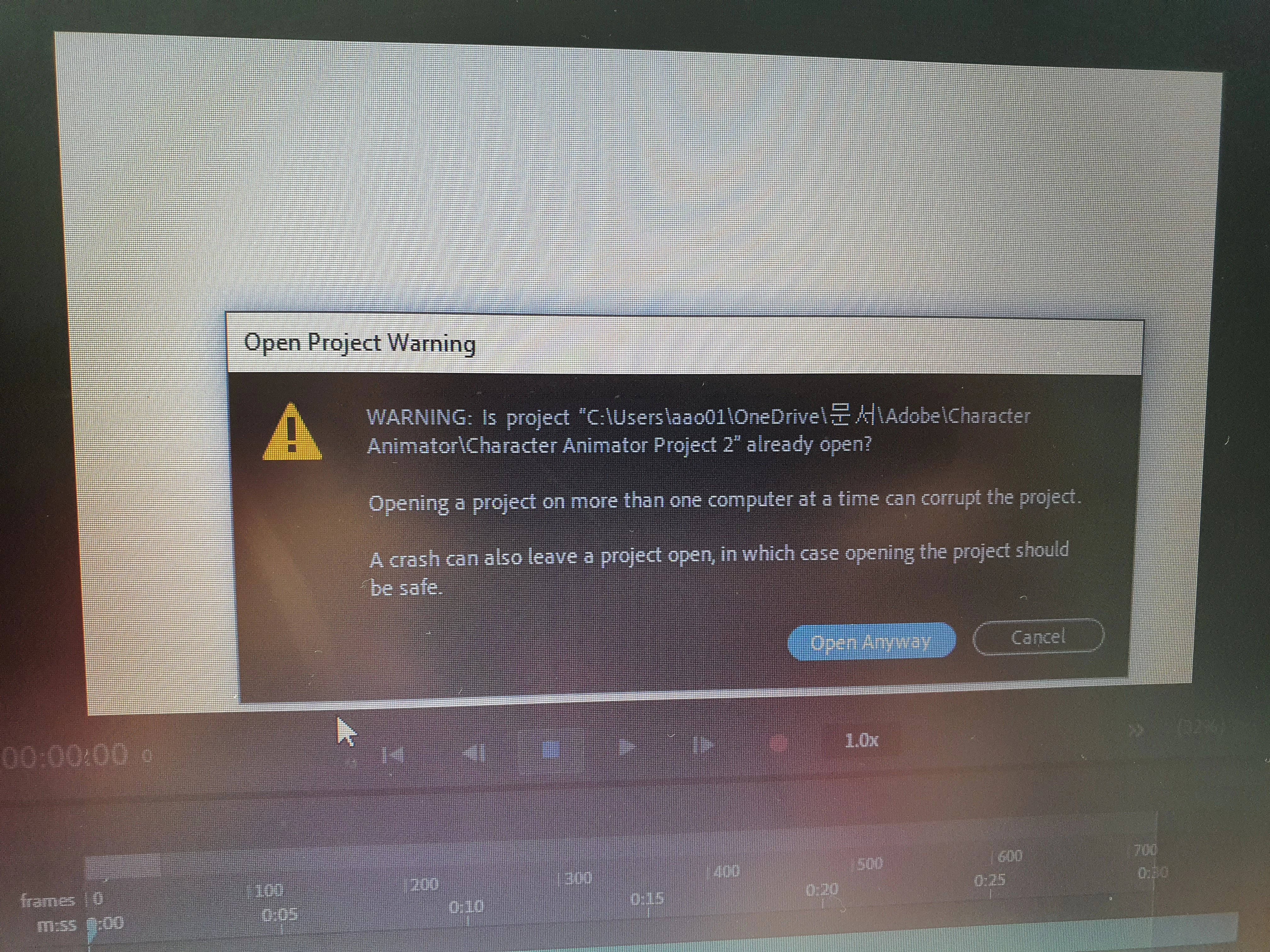

So again today, the error message pops up and it seems like I'm gonna lose all my works in my project. Does anybody know what I have to do in order not to lose my works in the project I'm working on? It happens very frequently which I never experienced other adobe programs like photoshop or illustrator

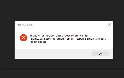

The error message below is one of the example of missing my files. Once I click "open anyway," my work disappears or another error message comes out and says "libgit2 error-1(4/corrupted loose referent file..)

This issue tends to pop up the most when working with cloud drives - which it looks like your path does include a "OneDrive" link. Because CH generates so many files in its Ch Data folder to help with the realtime animation stuff, if one of those gets out of sync it can start to cause issues like this. I recommend moving your project into a local folder and seeing if that solves the problem. You can always zip up a version and put it on OneDrive for backup later, but I don't recommend keeping your project and all the reference files there.

Thanks a lot! I just turned off one drive so I'm able to prevent the same problem in the future. But my project didn't come back and still shows the error message as the picture after moving it as you wrote. Is there anyway I can get them back?
