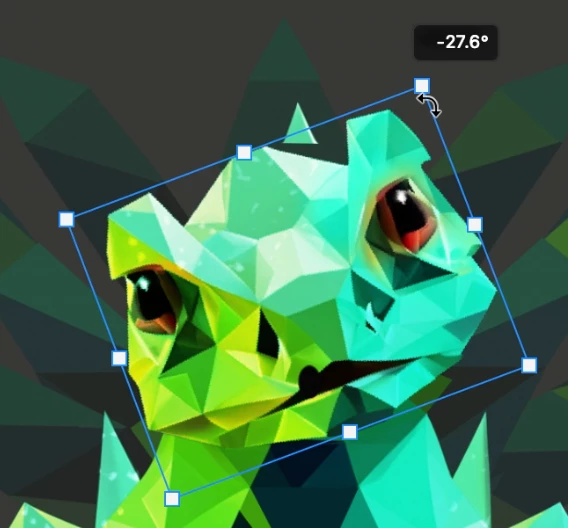

I'd like my lizard's head turn on a rotation as shown in the second photo left and right. What modifiers should I pin to do this?
Currently, it is bending the body and moving, which I am not looking for it to do.
Thanks in advance!
Diana
In Photoshop, how I would like the lizards head to turn left and right to my face's position

To make the head rotate independently of the body, click on the independent icon (crown icon) next to the head layer. Turning the head left and right as you move your own head in those directions requires separate views of the head (facing quarter left, quarter right and so on) and linking them with the proper views in rigging. It's a bit more complicated as each view requires its own set of eye and mouth layers.

Thanks a lot! I watched some video tutorials on the quarter turns, I'll look for a puppet that has it. I should be able to figure that out.
Alternatively, can this be achived easier with the dragger feature without my heads turn?
Thanks again,
Diana
TheOriginalGC
Aug 15, 2023 5:20 PM UTC
You can apply the dragger to anything, but unless it's part of a limb (using inverse kinematics), it won't rotate. Your best bet is an independent head with the pivot in the center.
