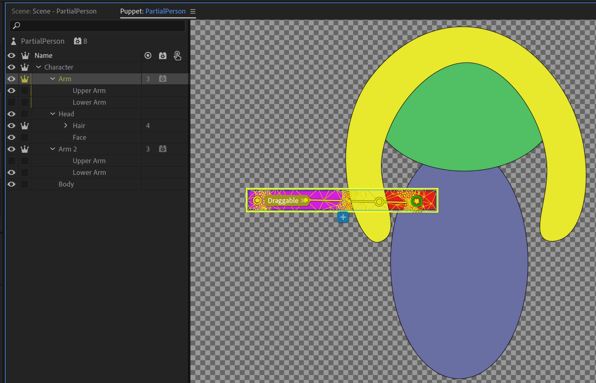

    alank99101739
    Dec 5, 2020 1:18 AM UTC
    Your approach *does* work with independent arms! I just did a variant of it.

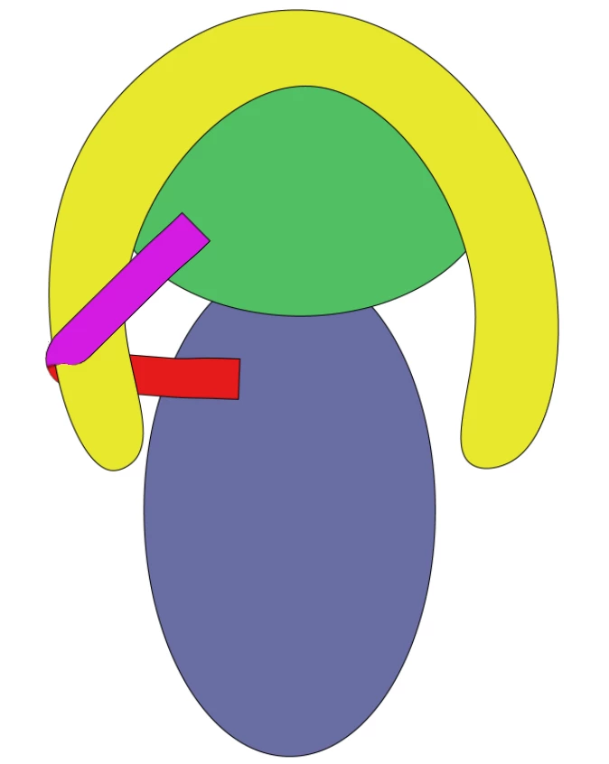

    I created a quick puppet following your video. I have an arm with two segments (red and purple). I made the arm independent. I put the sticks and dragger on the arm - everything ready to go. After the stick and draggers are on it, I duplicated the Arm layer *inside CH* (not in the artwork file). I then dragged the copy down behind the head (in front of the body). I then hid the upper arm segment in one copy, the lower arm segment in the other copy. Then, did I think it was your trick from a previous post - I put a "Dragger" behavior on each arm. I turned on the range limit to stop unwanted clicks from being picked up by accident on the behavior (necessary or else with left and right arms both will move all the time togther, not just the front/back arm copies). Combining the ideas worked!
    alank99101739
    Dec 5, 2020 1:28 AM UTC
    Here is the link to the puppet I created if anyone wants to play.  https://drive.google.com/file/d/1Gre-bDD5mq-BqGOxXr-OCgZ4fMvntgBG/view?usp=sharing.
    (Oh, I just remembered I had not set the target range on the extra dragger behaviors before I exported. That will be important when there are two hands in a real puppet I think.)
    And I had not added IK-Arm behavior - but that should not be a problem - just add it to both copies of the arm so they are identical.

    It is a well known issue with CH. Layers top to bottom control depth, but hierachy also matters. So you get this sort of case where you cannot get the nesting hierarchy and depths both working at the same time. Could you share the independence hierarchy of the layers? The more independence, the tricker things can be because independence says you MUST have the independent layer a child of something (you cannot move it elsewhere in the hierarchy) causing the problem.
    If you *really* want to have a go, here is my best suggestion.
    * make the upper arms dependent (not independent). Put them behind the hair (like you have now basically). So the upper arms are a part of the Body mesh.
    * Make the head not independent - so Body and Head share the same mesh.
    * Make the forearms independent, attached at the elbow to the upper arms. Because the upper arms are part of the Body and Head layer, you can put the forearms further up - put them above the Head so they appear in front.
    +MyCharacter
    - +Forearms
    - Head
    - - Hair
    - Body
    - - Upper Arms
    As long as Head and Body are not independnet, you can do this kind of trick to move the forearms up higher in the rigging hiearchy. Effectively Body and Head are a part of the "MyCharacter" mesh, and the forearms are attaching to the parent - the MyCharacter mesh. (Hmmm, maybe Head can be independent... but Body must not be.)
    But!! Doing this means you will have to put draggers on the elbows, then draggers on the hands. You cannot just drag by the hand to move the whole arm any more I think - you will have to drag the elbows then arms.
    What some people have done I think is to use triggers as well, so the arms are normally just normal, but you use swap sets and triggers to hide the normal arms and do clever stuff (with more pain to animate) for the few frames the need the arms in front.
    Yes. Its a pain. It would be great if there was some "layer depth" property instead of relying on layer order, but there isn't.
