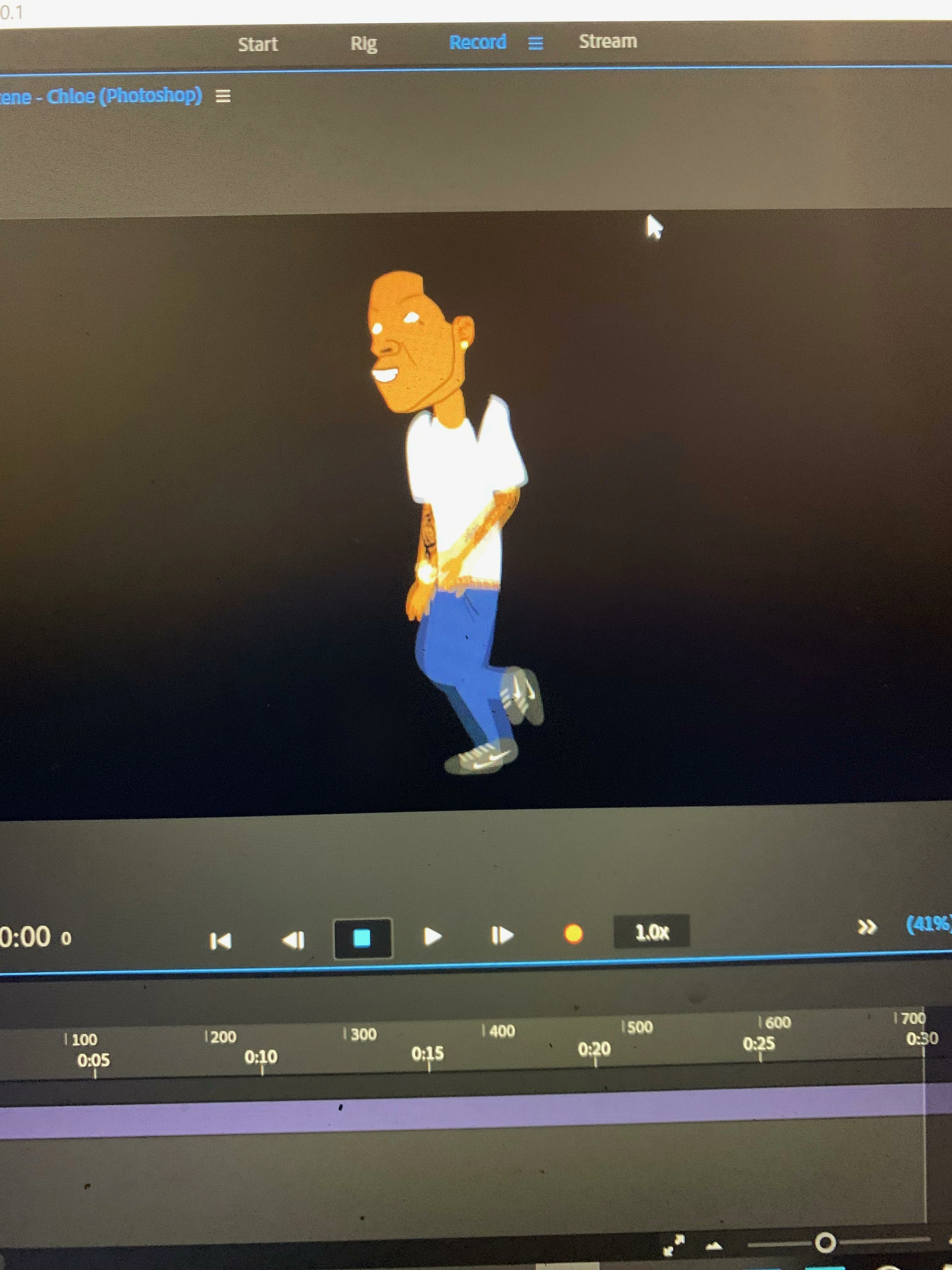

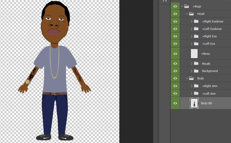

I made my puppet using the chloe puppet structure....I am a beginner. I want to learn how to build the left and right side profiles so i can program them with the walk behaviour i tried and my puppet keep falling apart. Im not understanding the hierarchy too well.

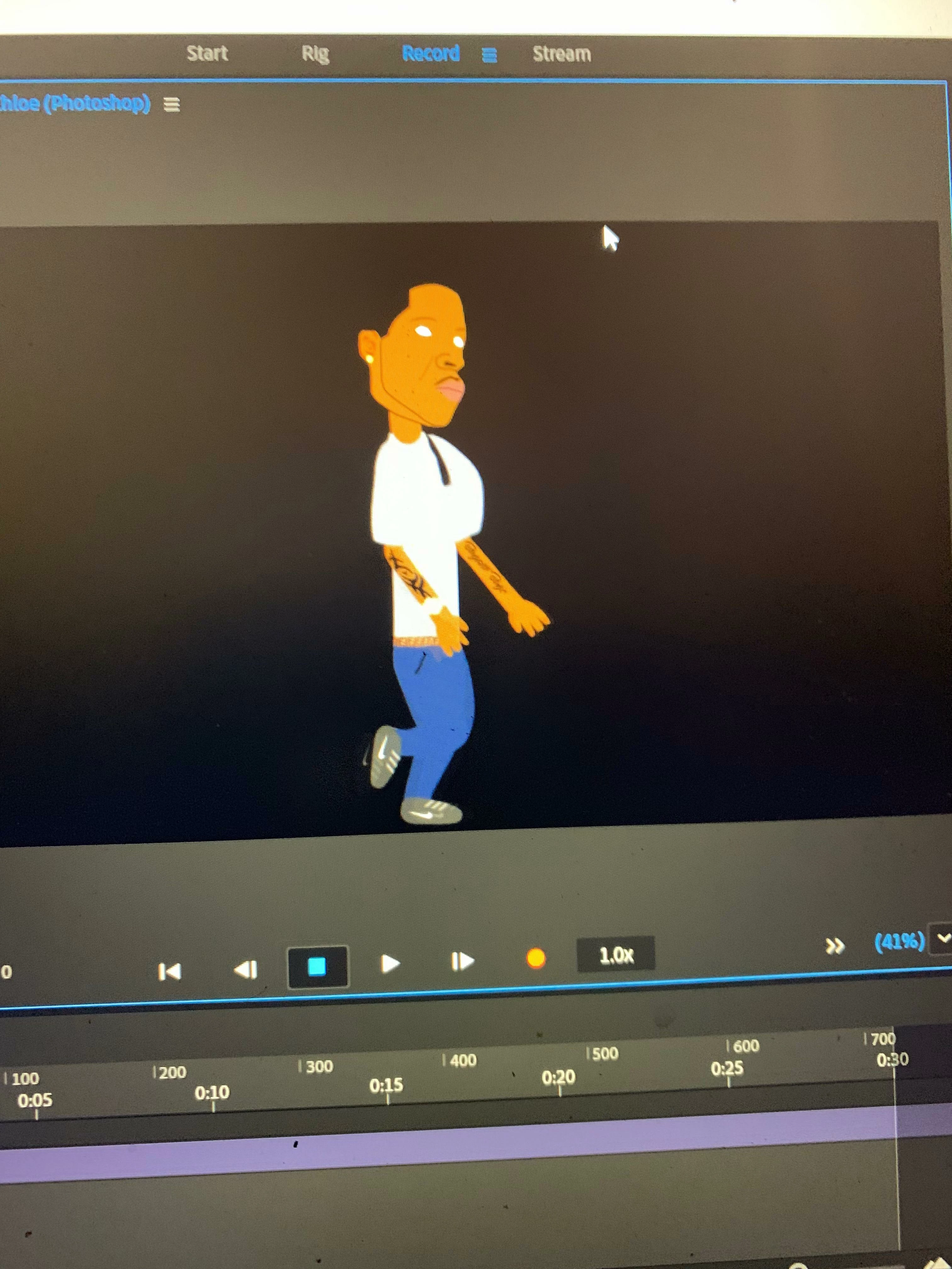

ok i got everything rigged and it seems to be working fine but the only problem im having is when i walk you see a gap between the arms and body and it looks weird. I staple the arm to the body, set sticks, and try to place tacks, but it still does it and it does it worst when i walk left rather than right. I have one walking behavior so idk how to adjust left and right arms individually .

I think this is the issue here:
Basically, the obvious way to tag the shoulders (while tagging wrists and elbows on the arms) doesn't work. The shoulder tags should be tagged on the body and the arms attach to that.
We realize that's confusing and hope to make it less so at some point, but haven't yet.

When you introduce the additional layer in your puppet, CH loses track of all the triggers, handles, sticks, draggers etc. The path to everything has changed - it thinks you deleted the puppet contents and inserted something different.
You have to do it - there is no choice if you want profiles - but it is a pain. The only way I know how to fix it is to rig it up again. E.g. In the rig hierachy, you can drag the layer for a trigger over the orange trigger - that will link it back up. Hopefully the trigger names are the same as the layer names, so the triggers are normally not that hard to do.
For draggers, sticks etc - its a matter of adding them back in yourself. You can do “undo” to get them back, but it will be messed up because the artwork file changed. Basically you are going to have to learn how to do all the rigging - or start from a puppet with profiles up front. But I would recommend learning the basic principles. Its not that hard, there are several tutorials around, and I think you are going to need to understand it at some stage.

Put simply, to do profiles you introduce another grouping layer and copy everything that needs to turn so there is a separate copy per turn. E.g. The root of the puppet might be “+Chloe” and under that you immediately put the full body profile layers (“+Left Profile”, “+Frontal”, “+Right Profile”, etc). Each one have a fully copy of the whole hierarchy of artwork.
So you have to get each profile all hooked together (attaching children to parents etc). The puppet you shared did not have that extra level of hierarchy in the puppet. I think you need to add it under “+Bugs”. That is create “+Frontal” group under “+Bugs” and move your Head and Body under Frontal.
