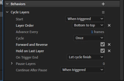

When adding the Cycle Layers behavior to the Left Quarter and Right Quarter positions, the layer order is important.  Thankfully, there is an option to change the order the layers cycle from top to bottom to bottom to top.  In my experience, the effect works best when the layers "advance every" 1 frame.  Obviously, you only need it to cycle once unless your puppet is drinking a lot of coffee.  The check boxes for "Forward and Reverse" and "Hold on Last Layer" also need to be checked.   On Trigger End, let the cycle finish.  And let it Continue After Pause when triggered.

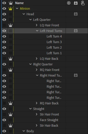

When I first did this, I had some tagging issues.  It's not too complicated, but I still managed to mess it up.  Here's how the tagging works (for me).
  • Head (tagged Head)
    • Left Quarter (tagged Left Quarter)
      • LQ Hair Front (not tagged... hair in front of the face)
      • Left Head Turns (tagged Left Quarter & uses cycle layers behavior)
        • Left Turn 4 (not tagged)
        • Left Turn 3 (not tagged)
        • Left Turn 2 (not tagged)
        • Left Turn 1 (not tagged)
      • LQ Hair Back (not tagged... hair behind the head, in front of the neck/shoulders)
    • Right Quarter (tagged Right Quarter)
      • RQ Hair Front (not tagged)
      • Right Head Turns (tagged Right Quarter & uses cycle layers behavior)
      • RQ Hair Back (not tagged)
    • Straight (tagged Frontal)
      • Str Hair Front (not tagged)
      • Face Straight (tagged Frontal)
      • Str Hair Back (not tagged)
