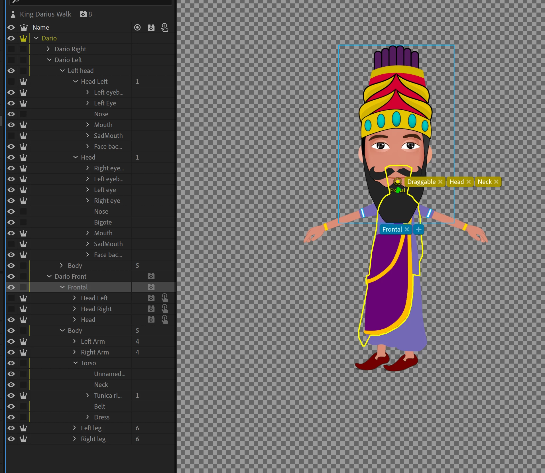

Your puppet had a knee tag on puppet's Hip. I fixed it.
I also added ”limb IK” and added drag tags to the heels.
Watch the YouTube video as it's difficult to explain this in English.
I hope it helps.

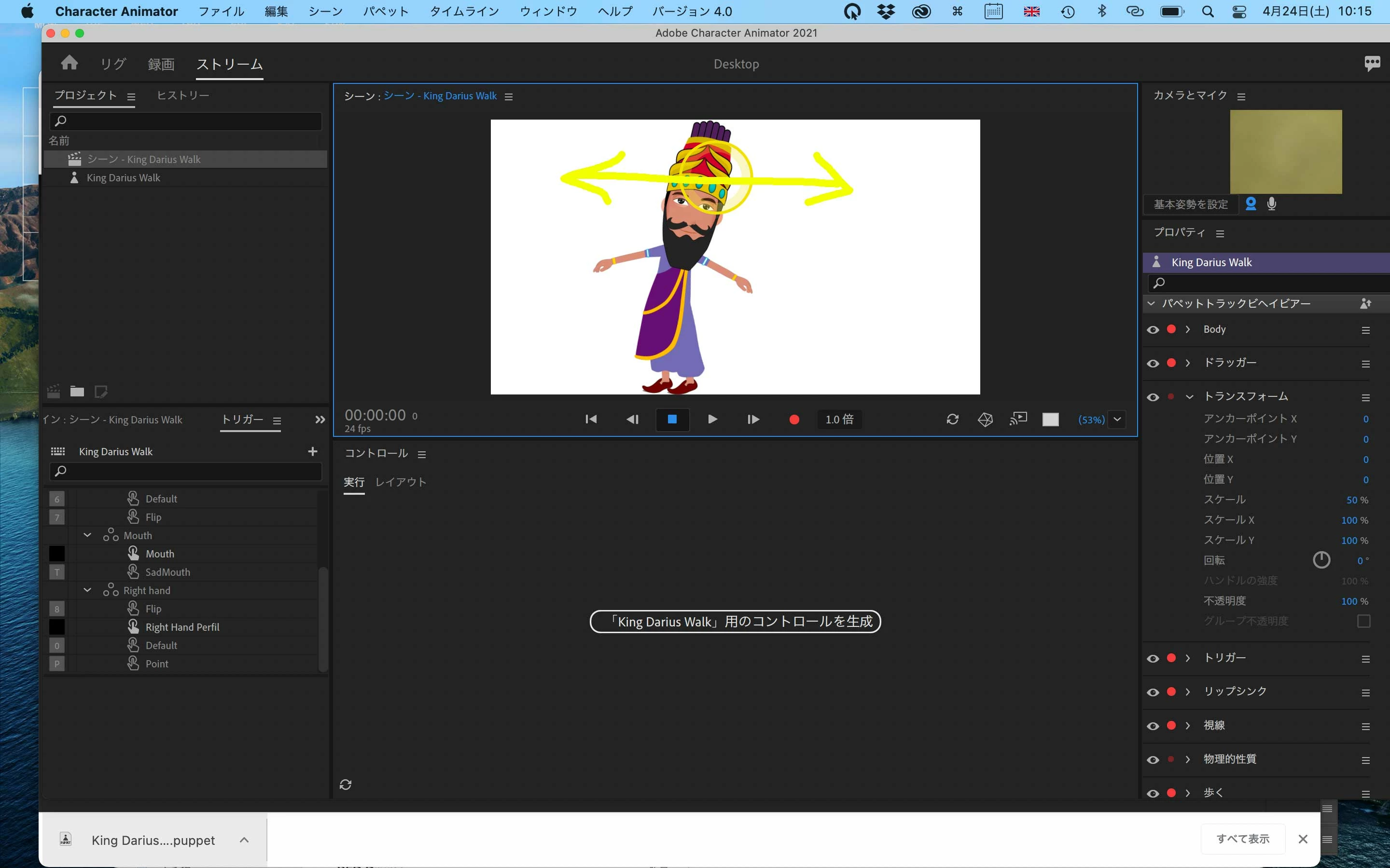

Doesn't the puppet move by dragging around the head like in the video?
If it doesn't work, there may be other causes.
https://youtu.be/aL4hslRGZ5g
Then I have a hard time helping you.
sorry.

There are various possible causes.
Is the puppet independent of the background?
Is there a crown mark on the puppet layer?
Did you add a draggable tag to your puppet's origin?
If possible, upload your puppet to Google Drive or Dropbox.
Thank you.
