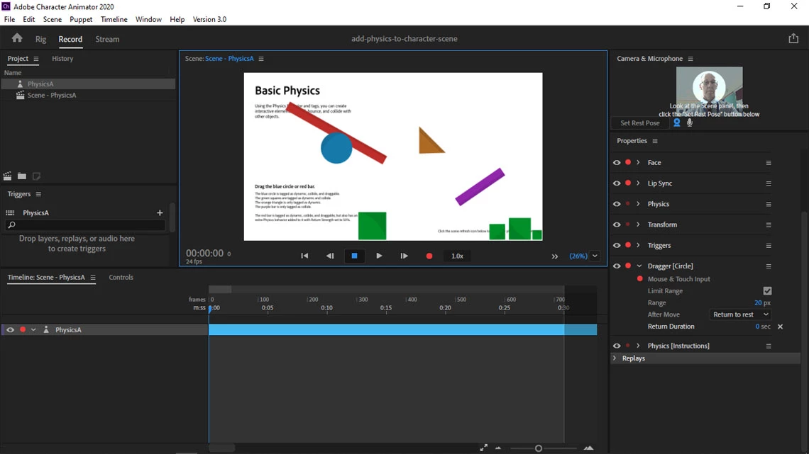

1 The dymamic platform is tagged with a drag behaviour and is draggable but has no visible behaviours in record mode.
2 The circle is tagged with a drag behaviour, the draggable behaviour is visible in the record mode but the circle is not draggable.

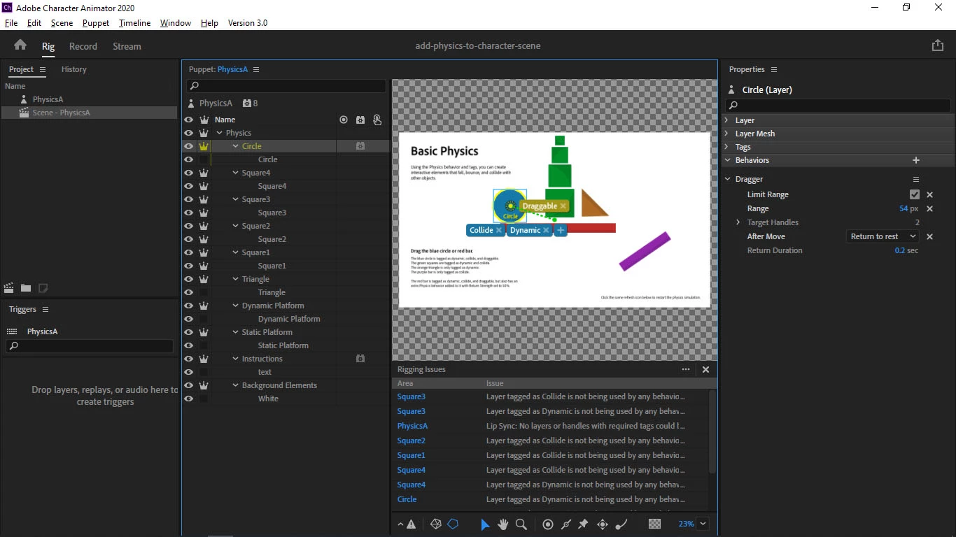

Here is the circle in rig mode. The circle is tagged and has the draggable behaviour icon in the puppet layers.

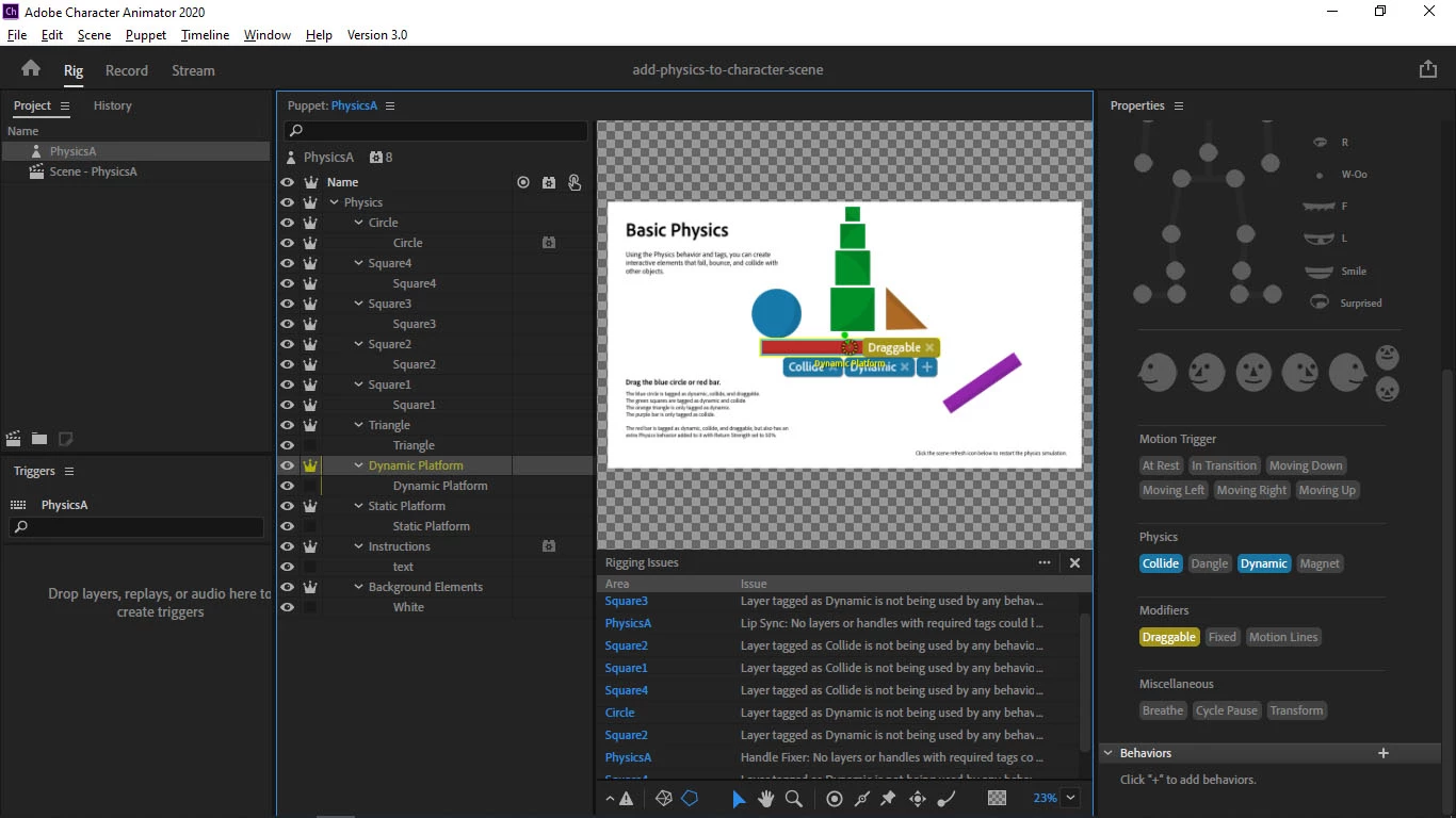

Here is the dynamic platform in rig mode. It is tagged but has no behaviour icon in the puppet layers or in the properties although it behaves as expected.

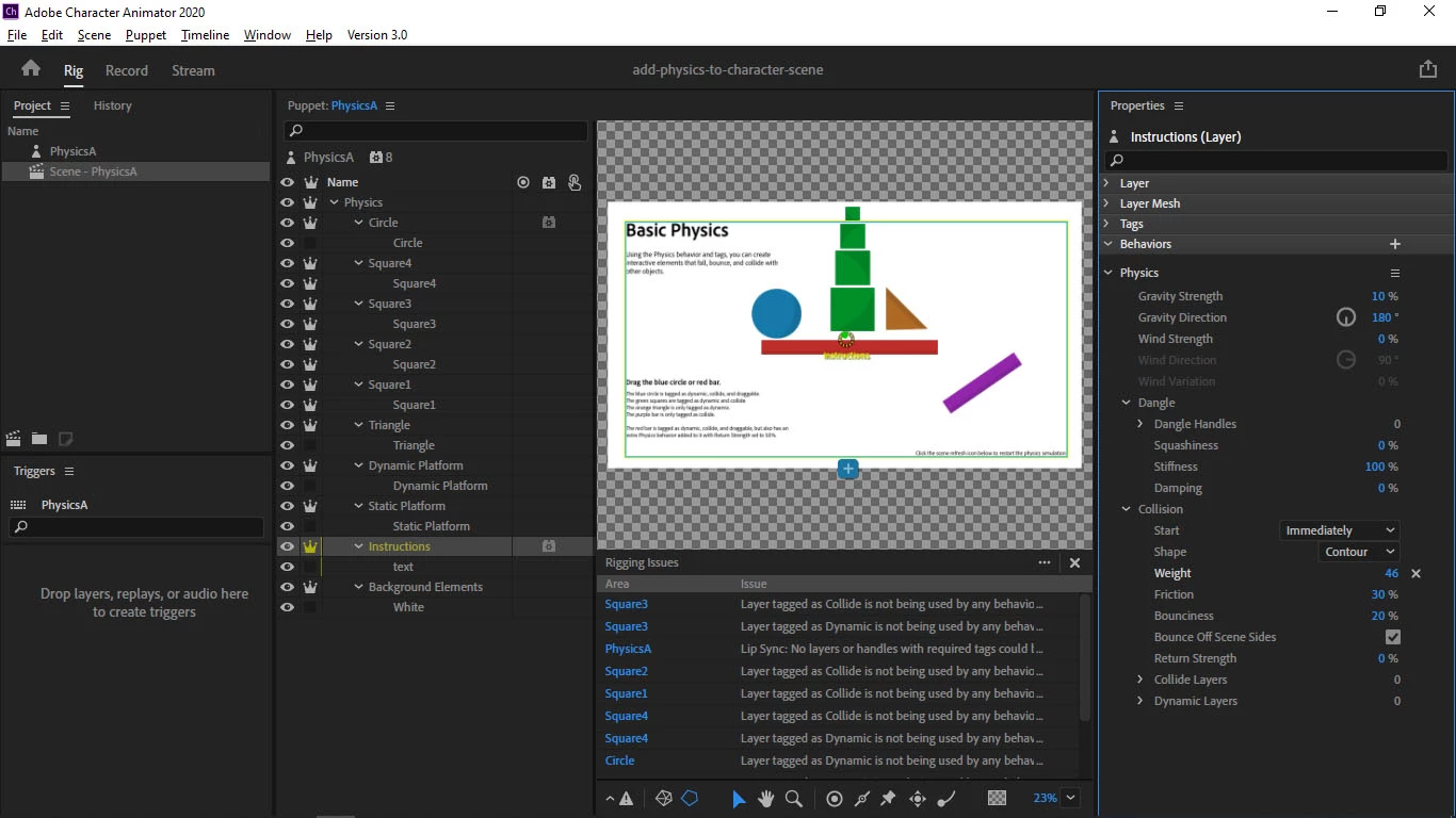

Here are the "instructions" in rig mode. These may contain the universal behaviours for the scene/puppet but there is no draggable behaviour here.

It looks like the circle layer has a dragger behavior on it but the platform layer does not. On the circle layer, see th4 little lego blog looking icon? That indicates there is a behavior on that layer. For circle, it looks like a dragger has been put on that layer.
However the platform does not seem to have a dragger behavior. I think you need to add this so you can arm either the circle dragger or the platform dragger and record that. I don't think you can record the platform layer without adding a dragger behavior to the platform layer
