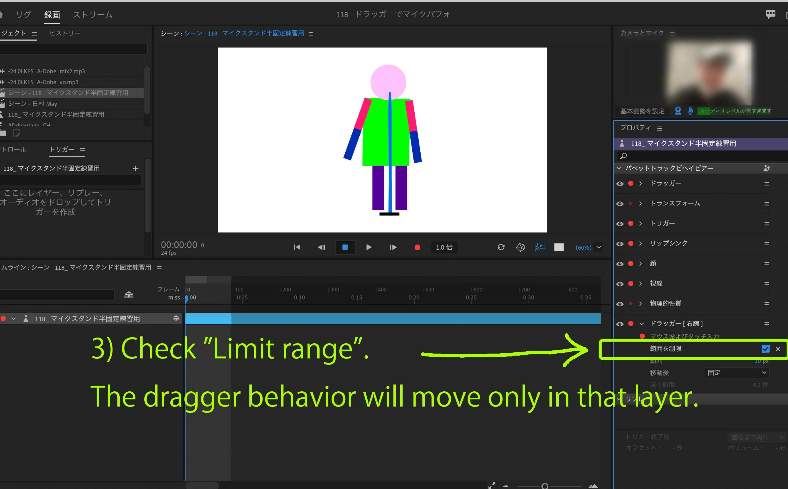

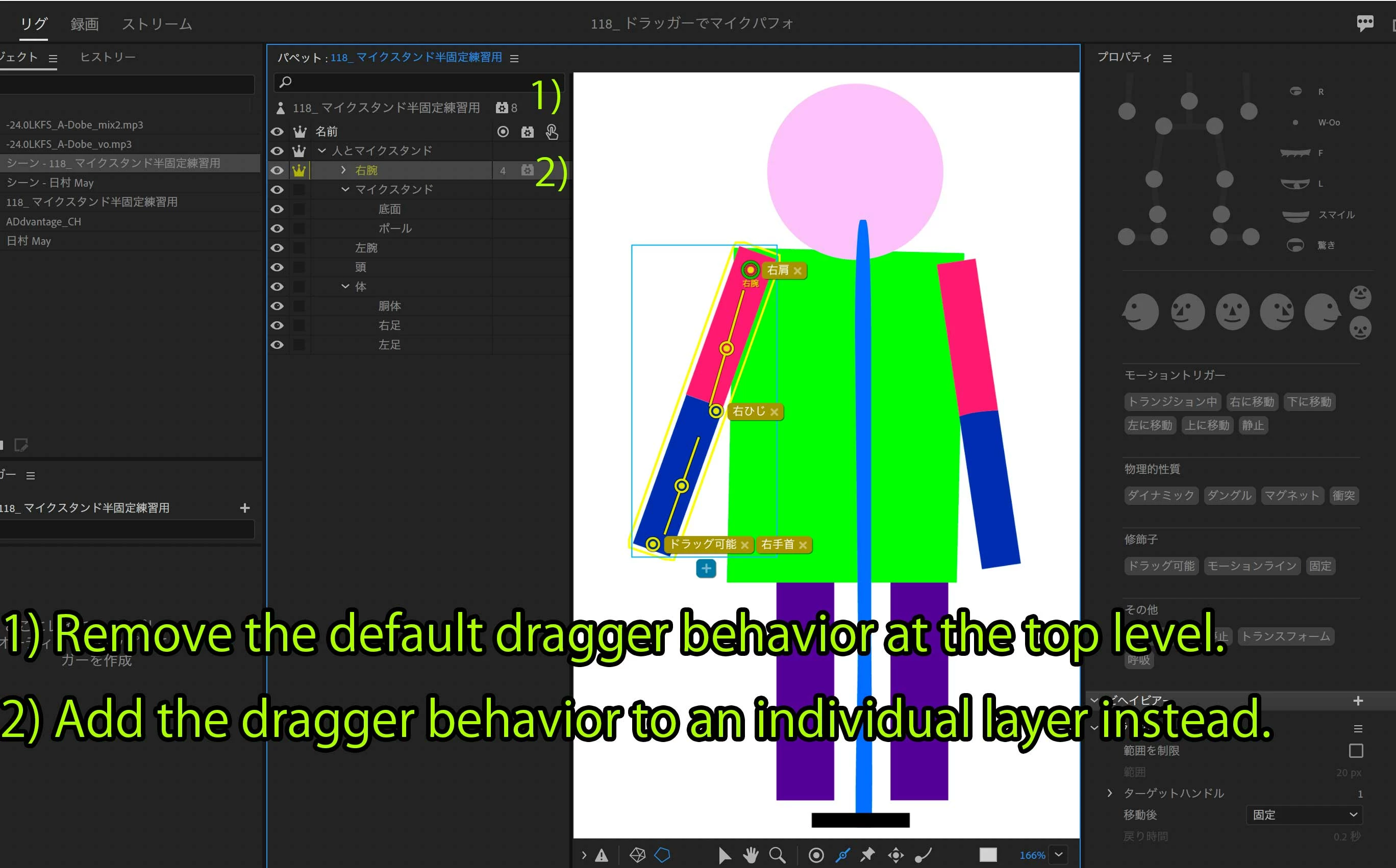

Here is how to solve it.
1) Remove the default dragger behavior at the top level.
2) Add the dragger behavior to an individual layer instead.
3) Check ”Limit range”.
The dragger behavior will move only in that layer.
