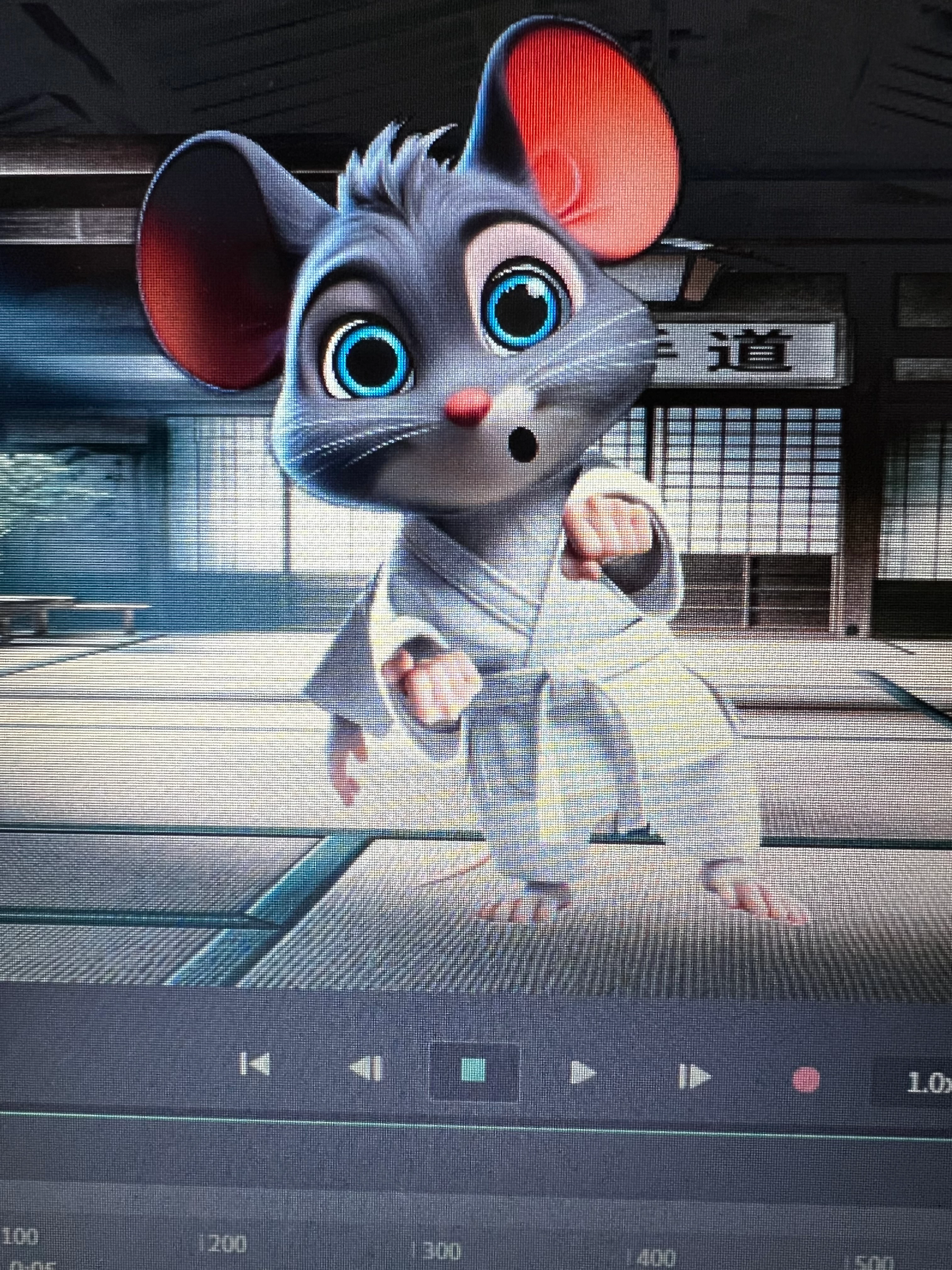

Hello, I am trying to turn off two layers with a hot key using a swap set. Basically I'm trying to make my character punch (One hand punching the other on the hip). The problem I am having is One arm is the default lets say the right arm. I have the R key on the punch layer and when that key is pressed the right arm disappears and the punch shows. My problem is the left arm is still showing (dangling there).
I've tried various combinations making multiple swap sets but I can't seem to find the right formula since only one layer can be the default. If I could make the left and right arm default then that would hide them both when the punch layer shows.
As you can see in the attached image the only one arm is hidden (the default) but not the other which is dangling. I leaned to the side so the arm would be clearer.

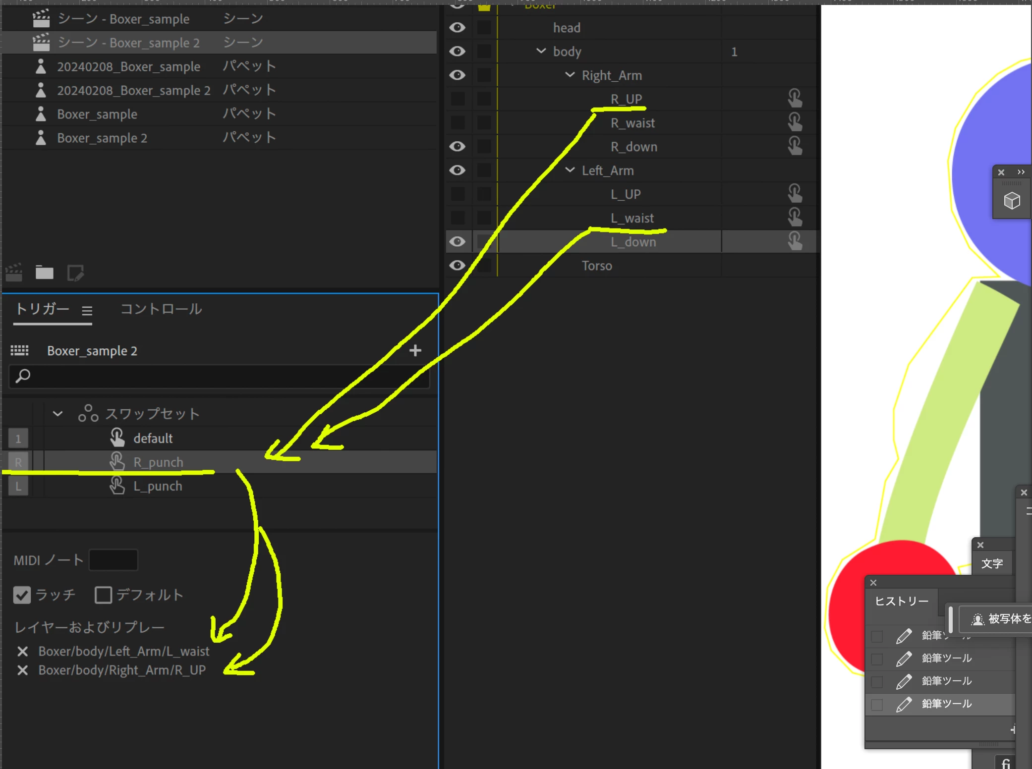

Have you tried to make the punching arms (both R and L) in one single layer and put it in both "Left Arm" and "Right Arm" swap set under the same shortcut key? I did a similar thing with crossed arms.

Multiple layer groups can be added to a swap set.
[L] key
When left arm is punched
(left arm punch and right arm is waist)
[R] key
When punching the right arm
(punch right arm and left arm at waist)
[1] key
Default
Sample puppets uploaded to GoogleDrive.
https://drive.google.com/file/d/1wjRQq6vStW36PX9NPklNKyUe4crcOQKm/view?usp=sharing
