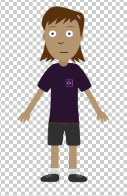

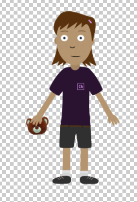

    Here is an example
    KJerryK
    Nov 21, 2017 4:53 PM UTC
    You can attach extra objects to puppet parts by dragging the objects into the rig panel of the puppet. For instance, if you want to attach a toy to a puppet's hand, you would drag the toy into the hand group. Then moving the hand also moves the toy.
