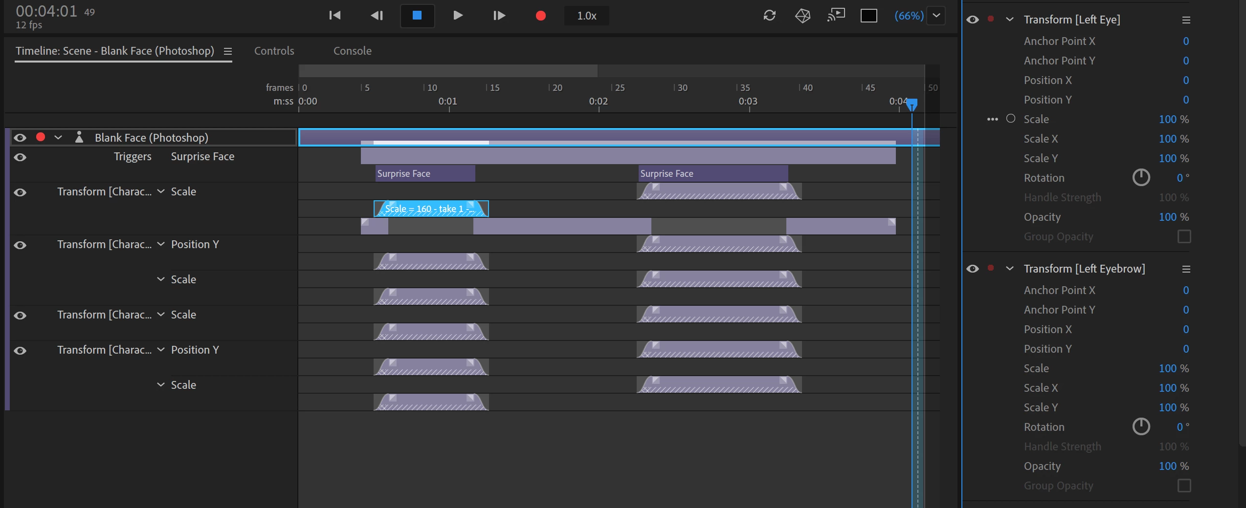

Two ideas come to mind:
With separate transform behaviors on the eyes and eyebrows you could make a grouped controls panel slider that would let you scale the eyes and move the brows together.
If it is more for a one off expression, it could probably be done the same transform behaviors and capture and time the recordings to drive them with a replay. Then you could trigger the expression as needed but have the brows and eyes usually operate normally.
I just made a (quick and dirty) example and then realized I'd done it in an internal build so I can't share the puppet itself, but here's a gif of the resulting look using the second approach. The first approach's main difference is that you would probably want to bind it to a knob/slider on a MIDI device. This would provide a more fine control over the degree and timing of the scaling where as the second combines them into a single key press.
What I don't have an easy way to do off hand is actually tie the eye scaling to the brow y position from the camera.
DT
