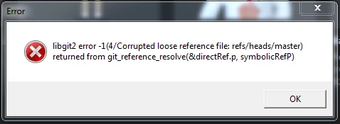

Is this corrupt save file recoverable?
I had a power outage today and lost a lot of work on a puppet. I have one backup but stupidly hadn't created a second. I keep my save file on a secondary drive so assumed it would be OK. I didn't anticipate a power outage corrupting the file however. Would it be possible for someone to look at the file for me to see if it is recoverable? As I have no idea how to do that. The error message is "Corrupted loose reference file: refs?heads/master)returned from git_revparse_single(&headp,repoP, specZ)".
If this is possible I can send the files or link to them via a PM. I don't want the puppet publicly accessible.
Thanks so much for any help.

    Jul 10, 2020 12:00 AM UTC
    Leaving this solution here for anyone that has tried everything on the adobe forums and isn't getting lucky. I found this solution on youtube by a guy called Alvin Yen... The video is a bit hard to understand, but it worked for me. The solution is simpler than it sounds, it took me about 3-4 minutes, including downloading the simple piece of software.
    1. Backup your project file just in case.
    2. Download SQLite (free software, DB Browser for SQLite)
    3. Open SQLite, click on "Open Database" and open the "odb.sqlite3" file located in Your project>Ch Data>repo.noindex
    4. Click on the "Browse Data" tab on SQLite, then go under "Size" and filter for the value 252 (type "252" where it says "Filter")
    5. If you have multiple results, click the top result where it says "BLOB" (under the "OID" tab, it might say something else)
    6. On the right side of the window, under the "Edit Database Cell", make sure the Mode is set to "Binary"
    7. You should see a code that looks like this "00 01 2c e9 af 58 78 95 aa 85 c4 cd 96 5a 11 ed 70 08 28 16" in the "Edit Database Cell". If not, make sure you clicked at the correct box of the result. The value will probably be split over two lines.
    8. Copy that code (Make sure you get all of it, and check that it's correct)
    9. Go to the "master file" located in "Your project>Ch Data>repo.noindex>refs>heads" and open it with a text editor (ex. Notepad or Notepad++)
    10. Delete any text that might exist in it, and paste the copied code (remove any spaces if they are not removed automatically, and make sure it's in a single line)
    11. Click save and try to open your project again.
    As far as I understand, this essentially tells Character Animator to load the exact previous autosave, which will solve the problem if your last save became corrupted for some reason. This worked for me and I only lost the past few hours of work instead of the weeks of work I had in that file. Hope this helps!

    Dec 16, 2018 10:31 AM UTC
    Hi there,
    I'm getting the same error:
    Libgit2 error 1(4?Corrupted loose reference file: refs/heads/master) returned from git_revparse_single(&headP, repoP, specZ)
    Also happened to me after a crash while working in Illustrator.
    It's affecting both my primary file and a backup. Both use the same Illustrator file as a puppet.
    I tried the solution above but my project folders don't contain any sqlite3 files.
    cheers

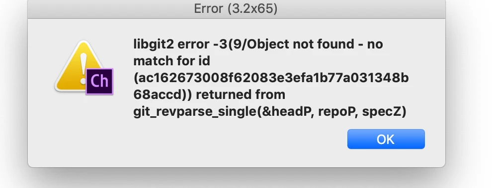

    Nov 15, 2018 10:12 PM UTC
    For anyone dealing with this issue... First zip your project just in case. Next, rename your Ch Data/repo.noindex/objects/odb.sqlite3 to odb.sqlite3OLD.  Next, rename your conflicted file (ie. Conflicted copy from.... .sqlite3) file to odb.sqlite3
    Now try opening the project again and it should work. For whatever reason, CA is creating a conflicted copy even when working on a single machine. It's possible it's creative cloud related since that's the directory we are using.
    Nov 15, 2018 9:12 PM UTC
    Same issue here. Is there an official path we can take to resolve this issue vs posting to this thread?
