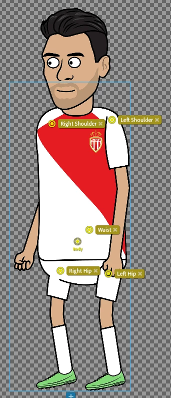

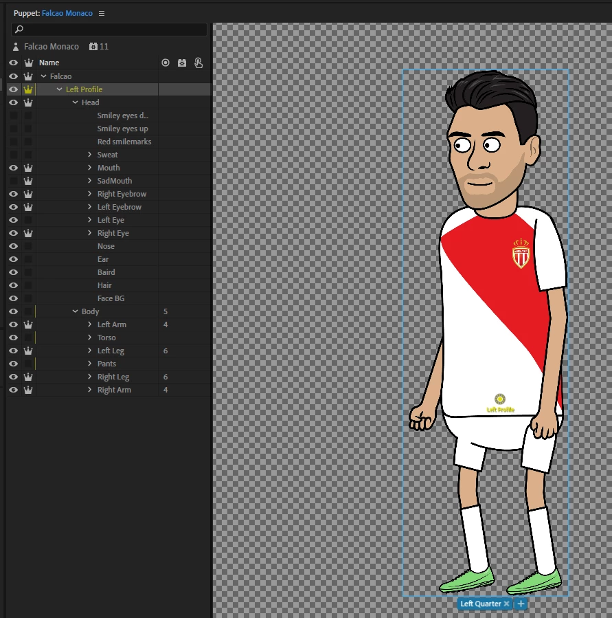

(1) In rig mode.
Show us a screenshot showing your rigged setup

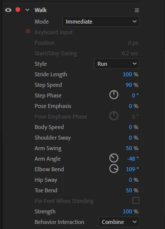

(2) Show us a screenshot that shows the behavior settings you walk through in the right side tab of the recording mode.

Thanks for the reply! Here's my rig and my settings for the walk behavior:

Thanks for attaching the screenshot.
From a quick glance, there seems to be no problem with the rigging.
of the walking behavior parameters.
Strength is currently set to 100%, how about setting it to 80% or so?
Thanks.
