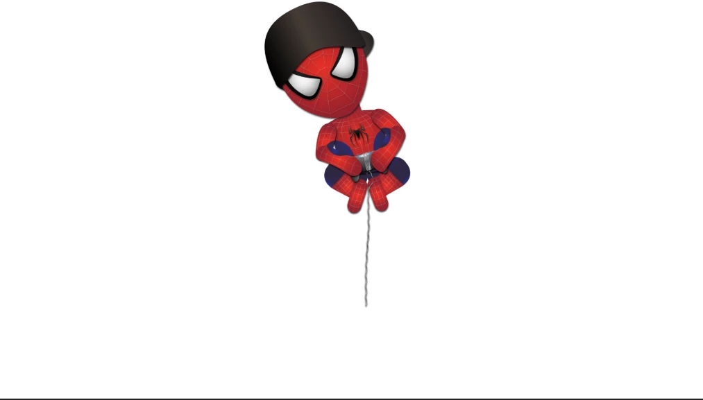

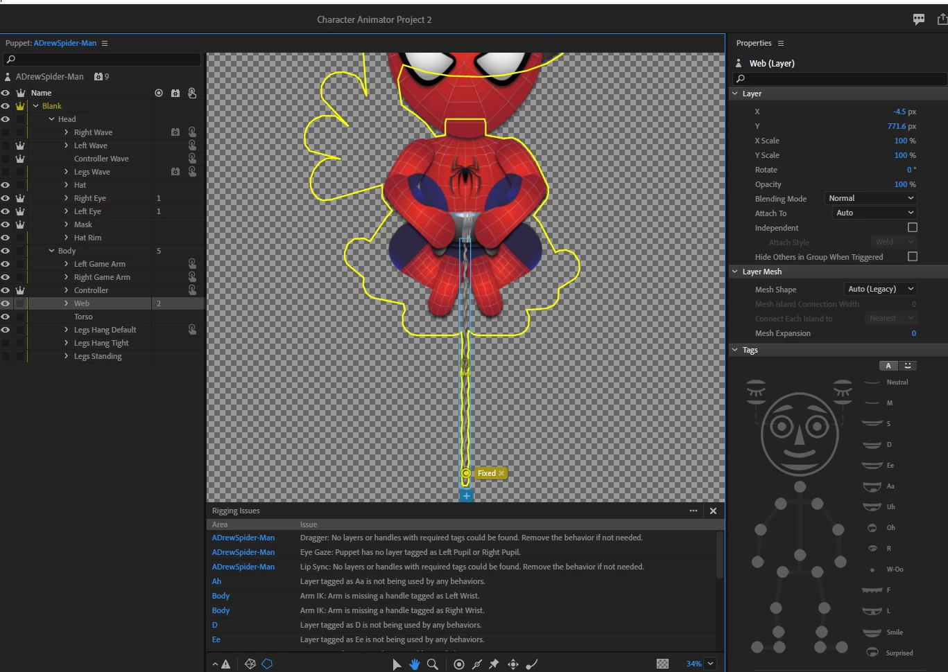

Having an issue pinning a part of my puppet and cant figure out what the issue is.  I want to pin the web so the character is swinging from that anchor point and it doesnt seem to reconigze it.  Whether its independant or not.
Also if i make it independant...

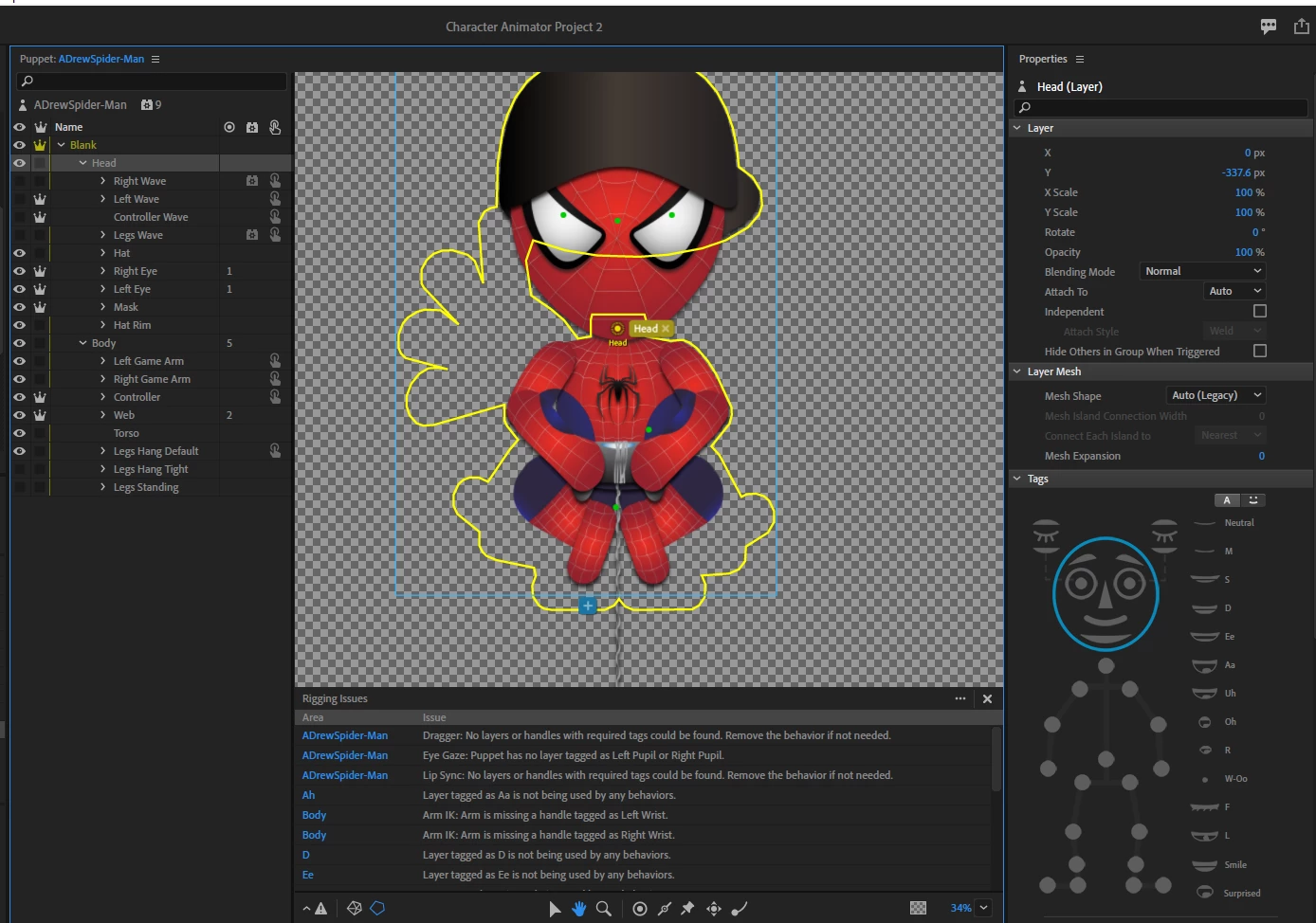

I noticed when i select the head, a number of green pins appear and this may have something to do with it.  Is there anyway to move these if thats the issue?  Thanks!

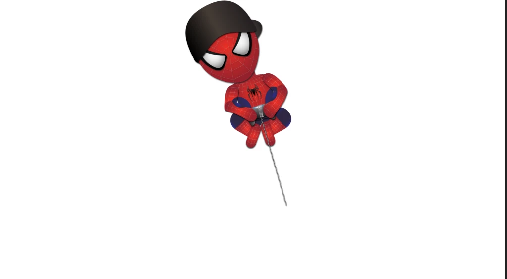

Thank you for the help!  I ended up putting a dangle on the web and rotated the puppet 180 degrees in OBS.  That worked well enough for me.  Thanks again for all the great tutorials OkaySamurai!

The green dots are where independent layer/groups are attached. So like the green dots you see on the head around the eyes are where the two independnt eye groups origins are (dotted line circle you should see if you selected either eye group).
Yeah, for something different like this I feel like it would be a trial and error process, but in general I would 1) make sure the fixed handle is on the Body group, and 2) drag all full character origin handles to this bottom point to be the origin for rotation - the Body & Blank origins in particular. If you see it bending somewhere else, it usually means there's an origin there. I talk about this a little here: https://youtu.be/CEJEVBHl0EE?t=219
