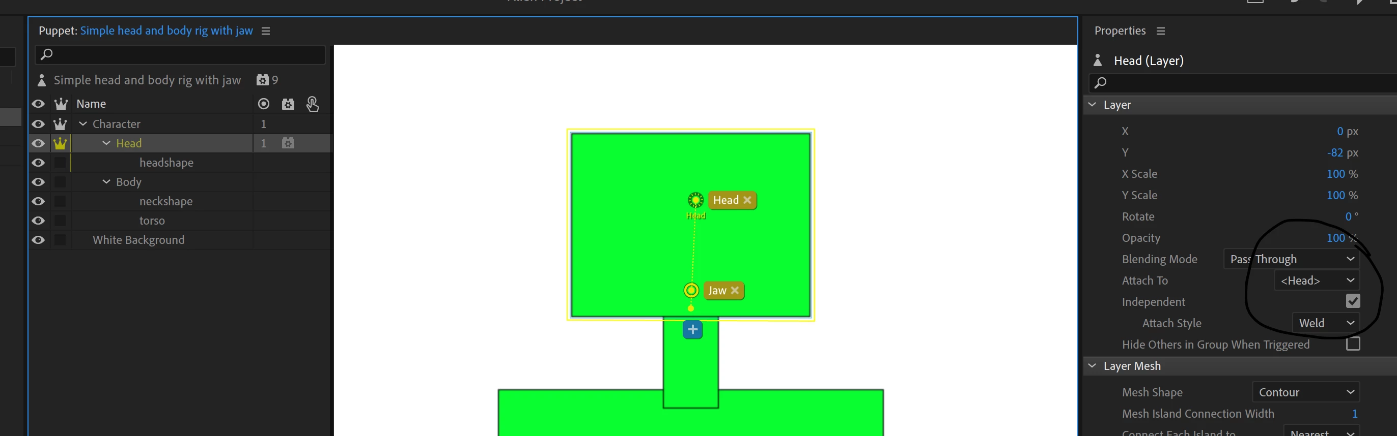

The issue here is that the body and head are on the same mesh, so any handle movement will affect the entire thing. I would recommend the following:
1. In PS/AI, create a group called +Character or +Animal or whatever. This group will contain your entire puppet. This is handy for a variety of hard to explain reasons(ease of adding a background, etc.)
2. If you want the head to distort without the body distorting, you need the make the head independent. Or alternatively, you could isolate the lower part of the face(e.g., jaw) onto an independent layer.
3. Assuming you make the entire head independent, this will fix your jaw issue, but create a new issue where the facetracking will move the head independent of the body. You fix this by attaching the head to the parent group and tagging that handle with the Head tag. I've attached a simple example for you. You will need to change the extension from .chproj to .puppet for this to work. The forum does not accept zip or .puppet files.
Adobe Employee
Feb 27, 2023 11:11 PM UTC
I've circled where you make the attachment of the Head group to the handle on the parent. I also added a 2nd Face behavior so you have separate control over the Head's tilt from the facetracking and the body's.

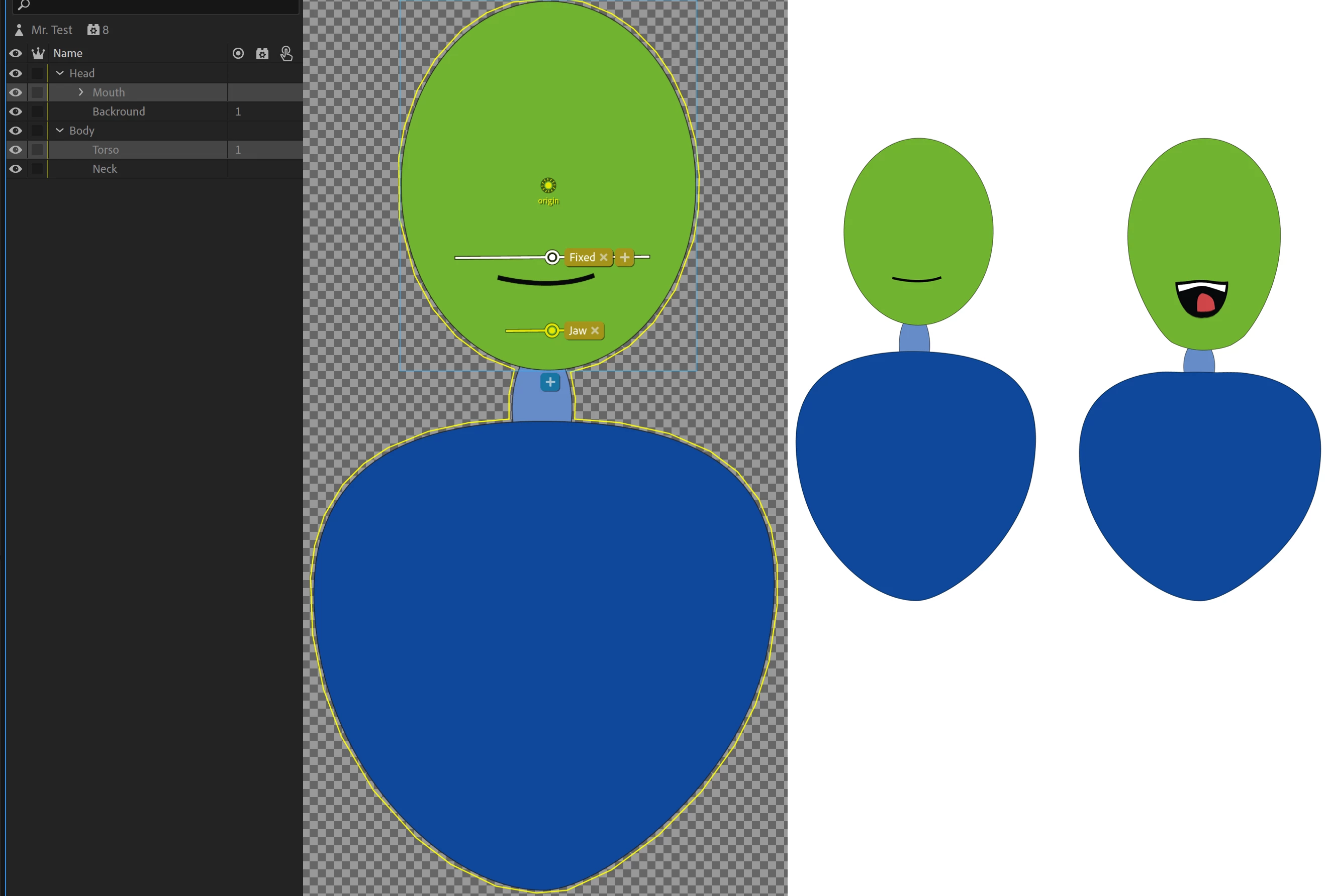

TheOriginalGC
Feb 27, 2023 4:25 PM UTC
Try making the head independent from the body.
