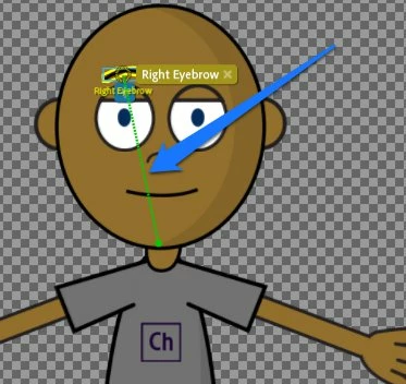

Just starting out with the program and after building my first character and using it in a video on YouTube I have some questions - these will be basic and if they have been asked before then please do send me to the relevant post.
On the blank puppet, there is a green dotted line from the eyebrow tag and other facial features to the base of the head (image attached) - I don't seem to have this - what is it and how do I get it?

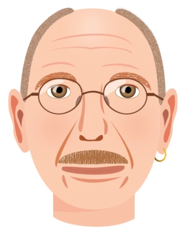

Hi Inwils,
   I must admit that I am not all that creative but I can copy. I have taken photos of people I like and used that as a basis for AI work. I put the image on the bottom layer and start building the elements. I start with the eyes since they are the most important. Then I build out from that. As an example, attached is a recreation of myself. Built up from a photo.
   Be well fellow pupeteer and have fun. - Platty
alank99101739
Aug 7, 2020 11:02 AM UTC
The green dotted line is related to a concept of independence. You can specify where a child layer that is independent attaches to its parent. Normally for eyebrows I would just attach where the eyebrows are - no need for the long dotted line. I normally have one for the head attaching to the neck. I want the pivot point to be near say the chin, so i would drag the origin marker of the head (which is at the center of the head artwork by default) down over the neck near the bottom of the head.
You do this for arms as well if independent. The origin will be in the center of the arm, but you want it to attach at the shoulder to the main body. So you drag the origin handle to where the shoulder overlaps with the body.
