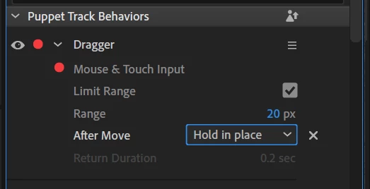

Feb 14, 2022 1:55 PM UTC
In the Dragger Behaviors there is a setting for "After Move" that is set "Return to Rest." Change that to "Hold in Place." so that the limbs always stop at whatever position you're using. (see illustration).
However, it is important to know that if the puppet ever gets reset, through rigging or whatever, then the limbs will return to the default positions in the original. The only way to adjust that is to adjust the limbs in the original PS or AI file.
