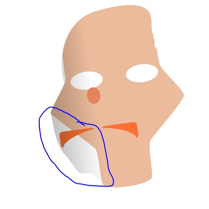

Is it possible for a puppet using parallax to have a piece of it hanging off the face background?

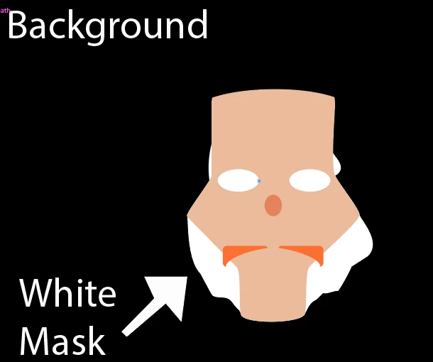

I can acheive this with a plain white background that is bigger than the puppet. In this example the red outline is a white background so that the mustache is visible.

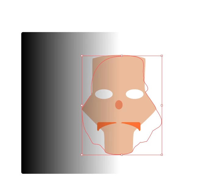

But if I put the puppet in front of any background that isn't solid white then you can see the white mask.
Is there anyway to make this work without using the white mask? I feel like it isn't possible, but I'm hoping someone can help. I tried to upload the puppet file, but it was giving me an error.

So this character has a high face parallax, with the mustache and other features in that layer. To create the parallax I used a clipping mask.
The problem is, since the mustache runs off of the face, I need to have a bigger clipping mask behind so that the mustache is visible, otherwise the mustache just goes to the edge of the face and vanishes. In the above image you can see the white mask with the overflow to allow for the mustache.
Now in front of any background, the white layer clipping mask is super obvious and ruins the character.
I have turned off it's visibility, but that just makes the whole character vanish and I have turned it's opacity to 1, but the whole character turns to 1 because it is a clipping mask.
Ive tried shaping the mask to the mustache, but then the mustache just vanished off the edge of the mask if there is any head movement at all.
