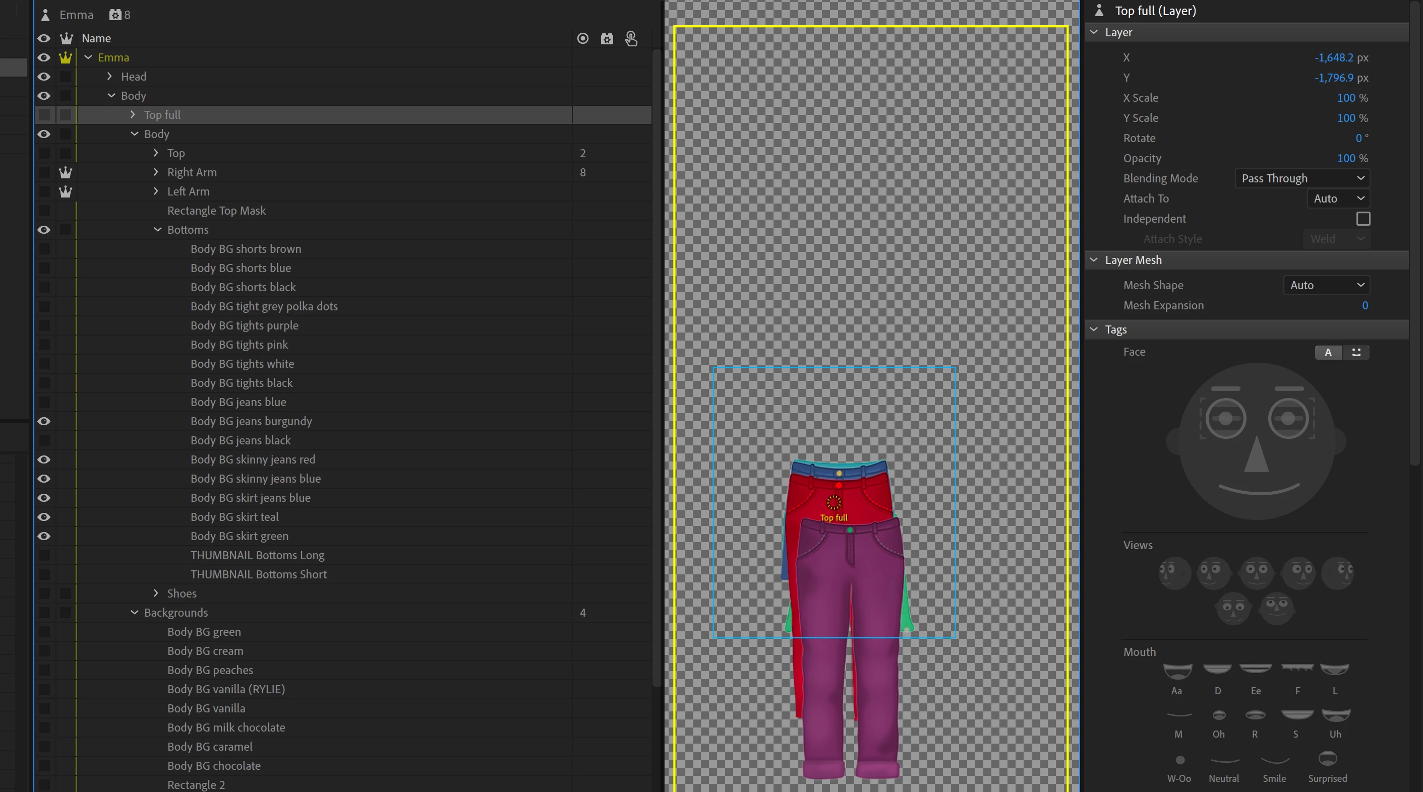

    Can you share the rigging hierarchy for you puppet?
    E.g. I am wondering if they both at the root level of your artwork file, and so effectively two puppets in the same file, each with its own origin. Normally you create a character at the root (e.g. “Chloe”) and put all the artwork under that.
    A screen shot of the rigging panel may help.

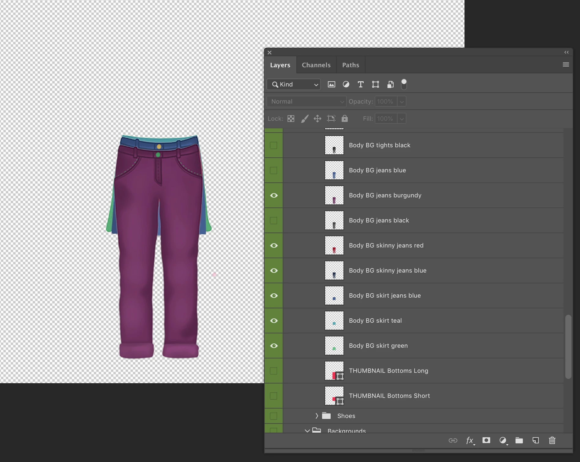

    Argh! actually not fixed - I just looked at the wrong layer. Screen shots attached.
    FROM PS:
    FROM CA:
