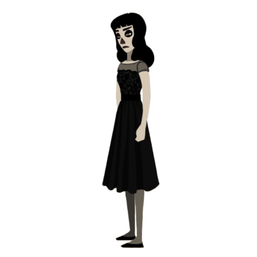

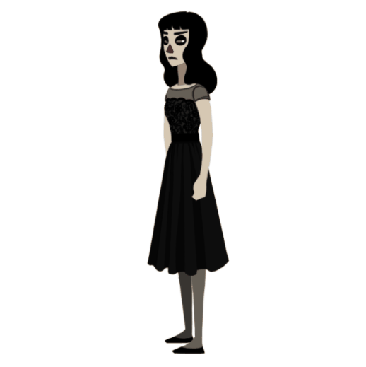

I've been encountering a weird quirk with my characters when setting up a walk behavior. It's like the whole puppet shifts down too far in relation to its standing position. Originally even the feet would be pushed lower in the frame, until I fixed them in place. Anyone know what could be causing this? Thanks in advanced!

Ok, so I found out that my legs were not attaching to the body, so the legs were shifting up on the body. Earlier in the process I had set the Attach To for the legs to Fixed points I placed on the Body.
I set it back to Auto, which made it so the legs now attach properly to the Body.
However now I'm back to my original issue of the puppet shifting down in the frame entirely, so the feet don't line up along the same plane. I'm not seeing this issue with the sample puppets, so I'm not sure what I'm missing.
