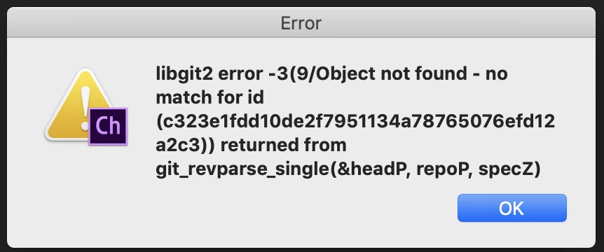

I have been working on a project off and on and recently added some triggers to a puppet. Everything seemed to run fine until I closed the project and reopened it, and now the project doesn't seem to be loading up at all and I get this error message:
libgit2 error -3(9/Object not found - no match for id (c323e1fdd10de2f7951134a78765076efd12a2c3)) returned from git_revparse_single(&headP, repoP, specZ)
Is there a way to fix this, or would I just have to restart the project from scratch? And if so, how do I avoid this issue in the future?

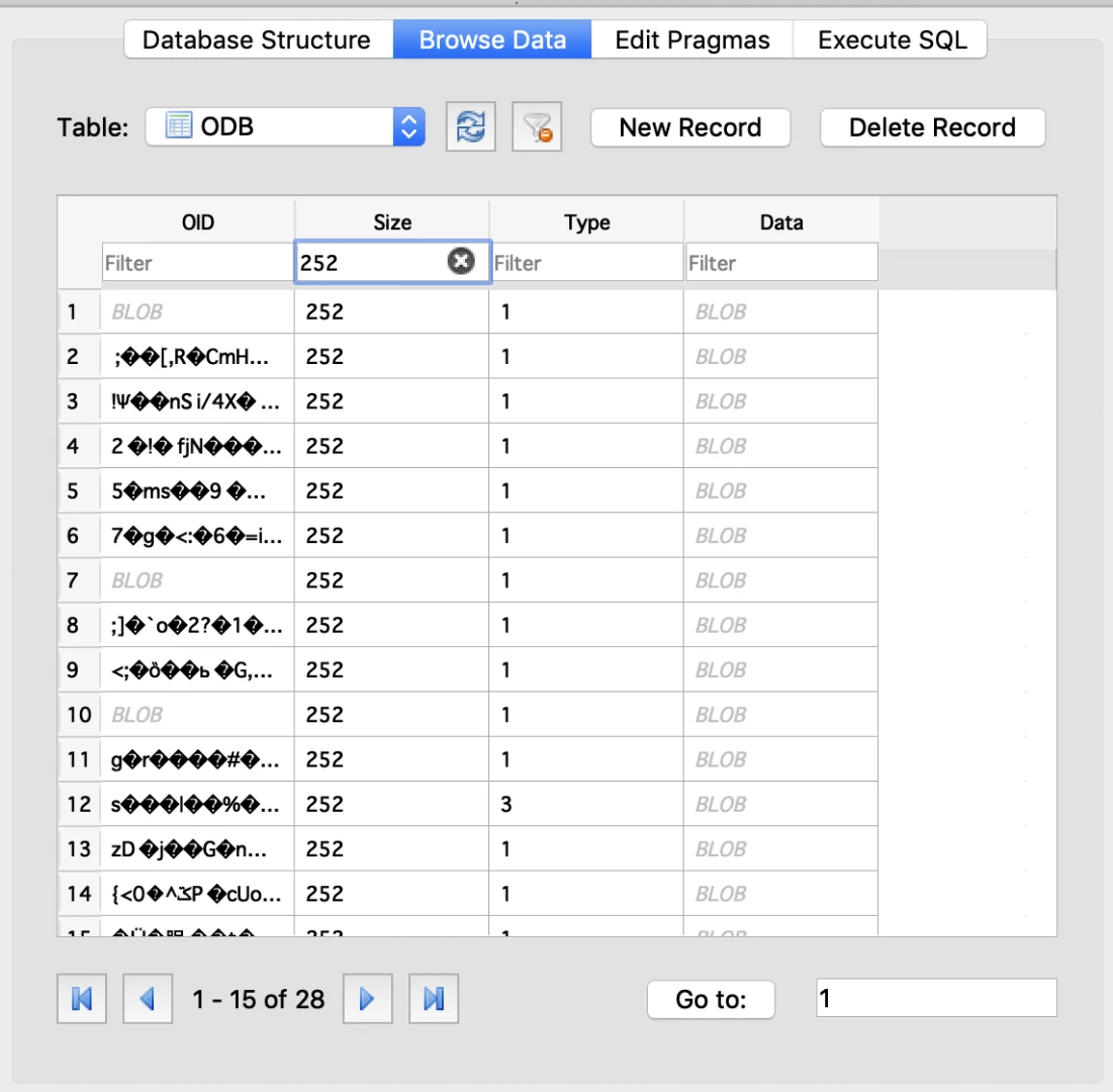

Jan 23, 2019 5:56 PM UTC
Thanks for your quick response, but I'm still stuck trying to find the correct size. As you can see I have about 30 options with the size of 252:
I've tried copying and replacing the head master file with a few of the binary codes, but they just give me new error messages.
How do I know which one is correct?
