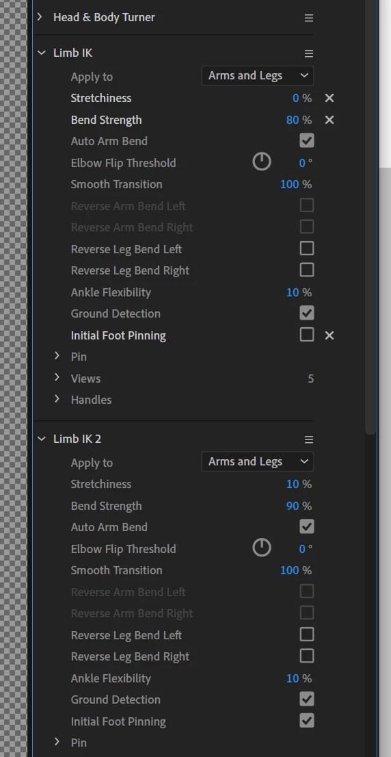

OK. You've got 2 LimbIK behaviors on the top level of the puppet. I suggest putting one on each view(Standing, Left Quarter, Right Quarter) of the puppet. That seemed to fix it for me.
